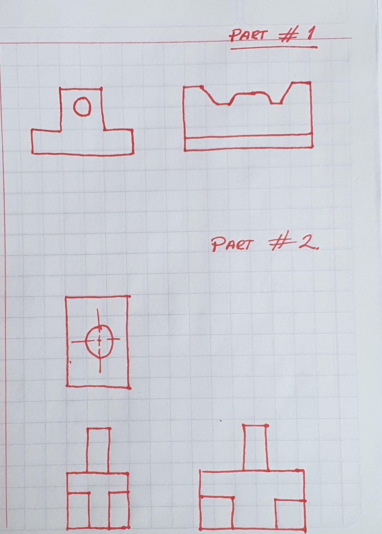

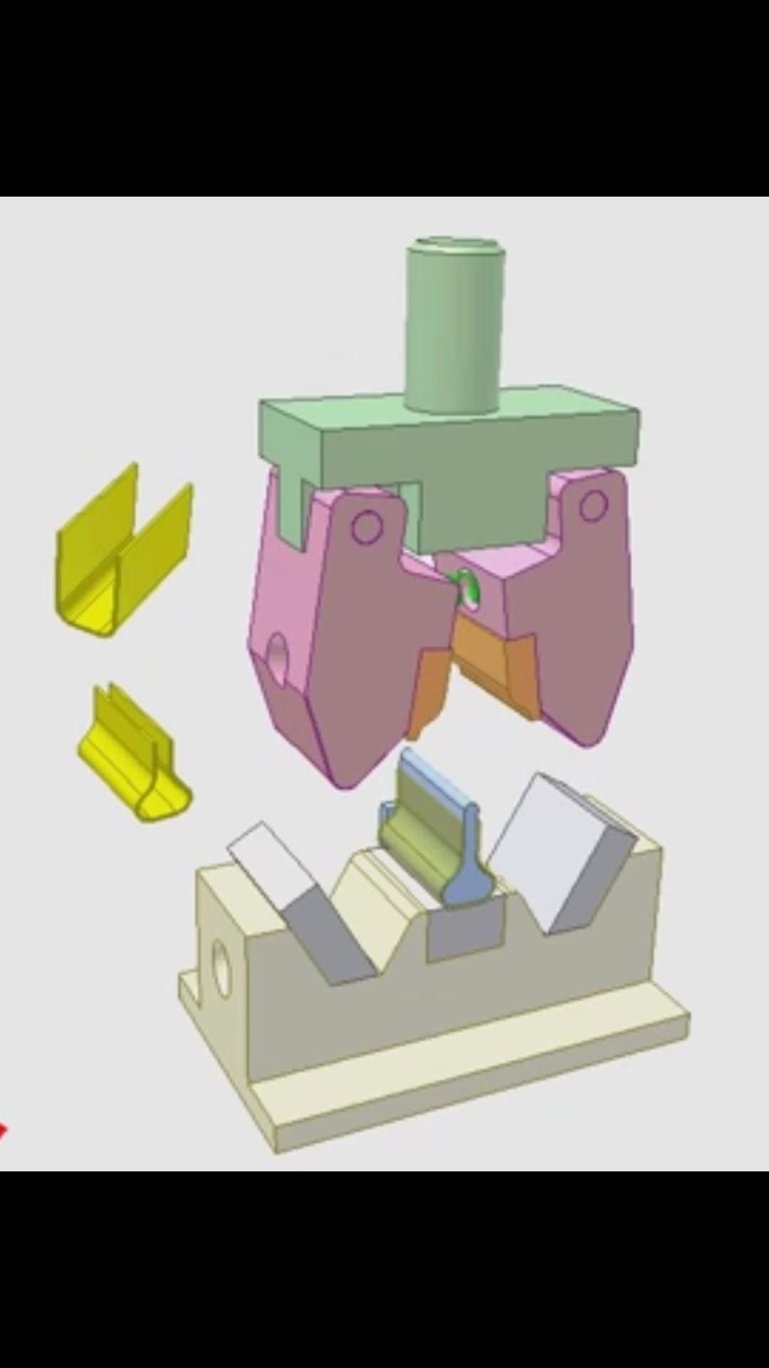

I have this school project, can you help me?
I need to draw this in CATIA, but I dont know how to start. Only thing I know is that I need to draw every part alone and then put it together

Make one part (yellow part) using the tool shown (light brown, green, pink, orange, gray and blue parts).
Yellow part needs to have a ''U'' pre-form and then final form.
Second: Order and indentify with numbers each part from larger to smaller.
1 - light brown.
2 - green.
3 - pink.
4 - gray.
5 - yellow.
6 - blue.
7 - orange.
Third: Using a piece of paper, make an sketch views (I suggest you make only three - Front, Upper and Lateral Right -- Tip: use third angle --) of each part (without dimensions), starting from the number one (obviusly).
Be careful because we have three repeated parts, pink, orange and gray (only left & right) so you need to make only one.

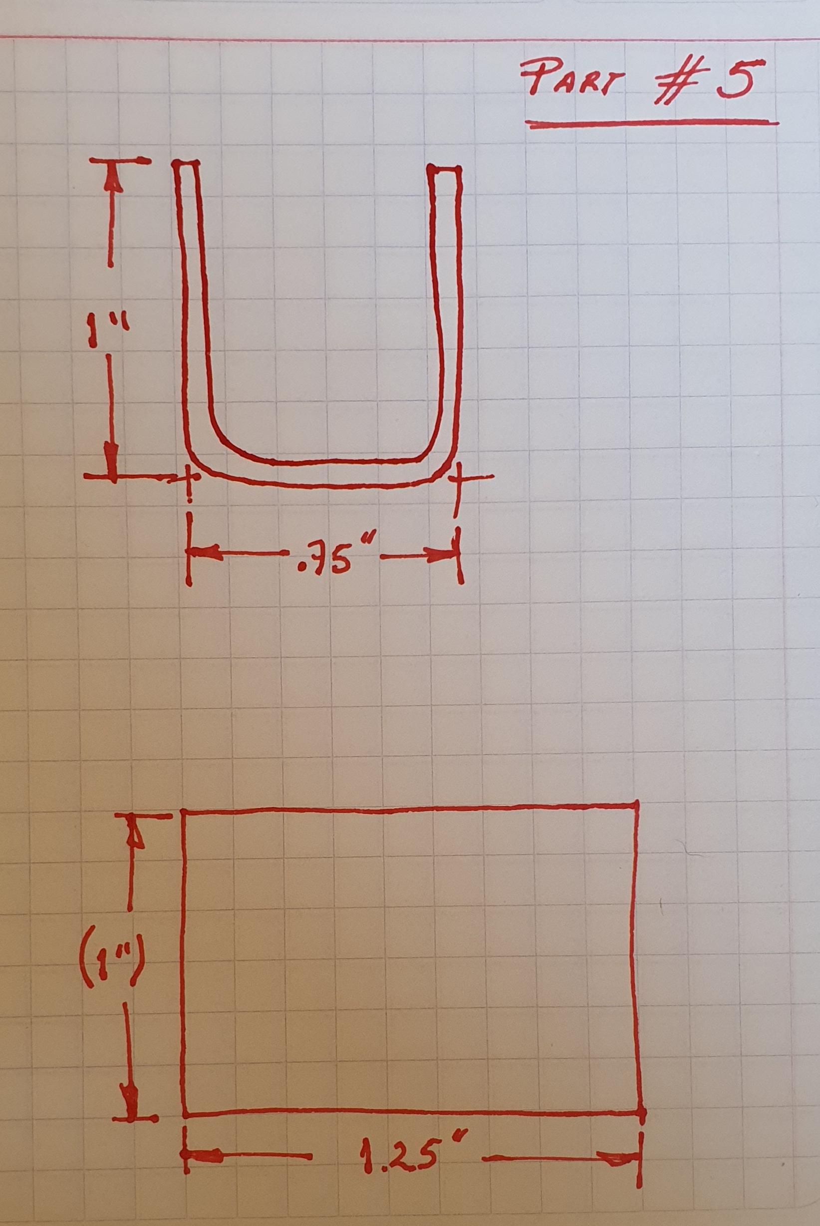

Fourth: Assign dimensions, now starting with number 5 because it is what you need, the product. You could use: 1'' x .75'' x 1.25'' (See attach). And from now on, you may give dimensions to the next components.
Fifth: Now you can model them in CATIA.
