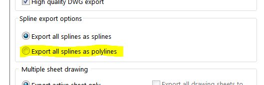

I have saved a flat face on my solidworks model as a dxf file and it all looks fine. But when I got on Techsoft 2D Design, I go: File> Import> and select the dxf file. Then it opens an options window and I select mm and then press ok. Then it imports all the straight lines fine but not the splines. Why doesn't 2d design import the splines?

When exporting the DXF from solidworks you may want to try switching the 'spline export options' to 'export all splines as polylines' and see if that works well enough for your purpose.

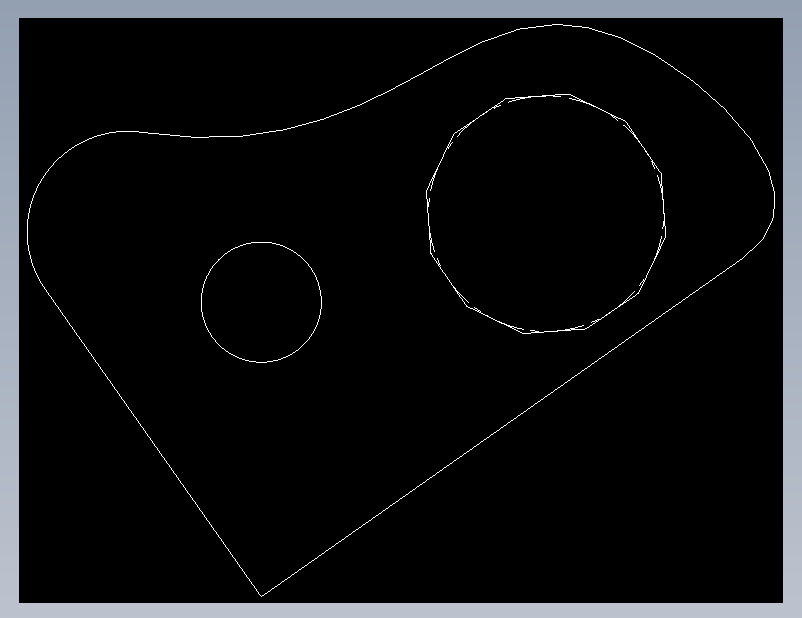

As a test, try making a new sketch on your flat model face. In the sketch, convert all of the model edges to sketch geometry. Save the sketch as a DXF, and import it to your 2D program.
Attached is a DXF created from a sketch. It contains 2 lines, 1 circle, 1 arc, 1 spline, and a 12 sided polygon (lines and circle). Does it import correctly?
