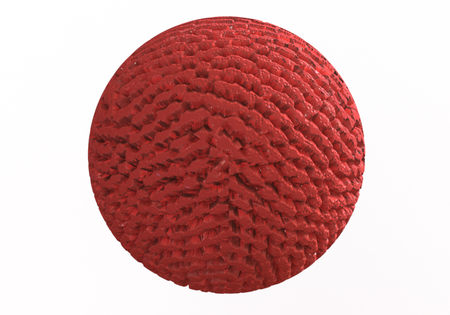

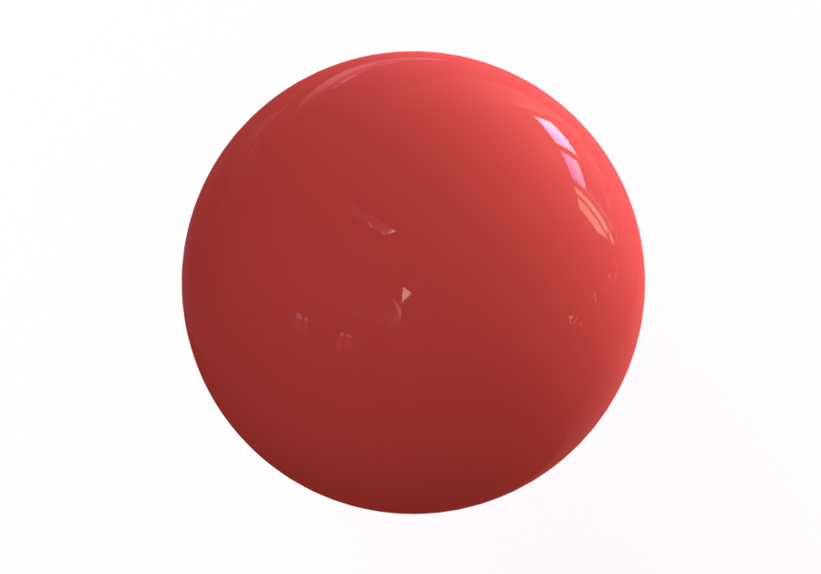

You can also bump and displacement map in PhotoView 360 if you are using SolidWorks for your rendering - see standard and bump/displacement mapped sphere images attached. Let me know if that would help and I will gladly post a tutorial :)

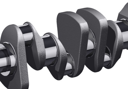

I have enclosed an example of a crankshaft I created. There is a machined surface and a cast surface. To create the "cast iron" effect I added a bump map to the Diffuse Channel. This map was simply a photograph of sand.

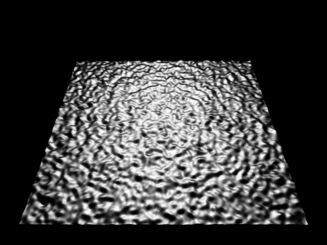

I think procedural maps could do the same effect. Also, in Max you can use "noise" to add a bumpy texture.
