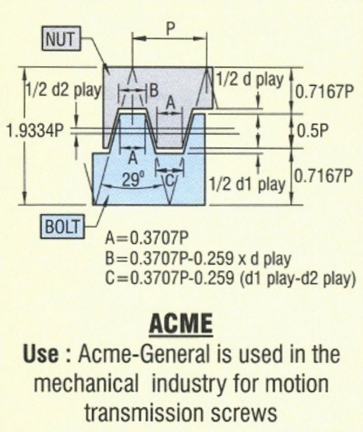

How can I create a acme thread profile using coil feature? Rolo 18 Sep, 2013 03:39 PM Some time ago I did it, but I never wrote the nessesary steps to be followed and I`ve been needing to buit some shafts and nuts using this thread system. Please somebody help me!!!!! 1 Answer Raza Usman Answered on 19 Sep, 2013 06:28 AM If you are referring to the Technical Details... Here's what I got... If you have problem with the software use please do ask... Acme.jpg
