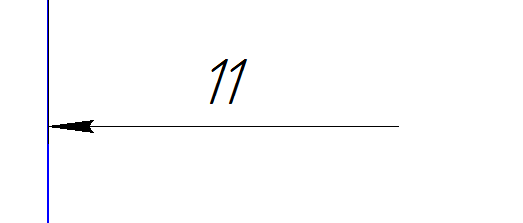

Hi everyone!
Please tell me about this dimension (look at picture).
I set dimension at picture in other software. But I dont know how can I do this in SW.
Ordinate (in SW) is not the same thing.

Not sure about that, but you can remove the chain leaders from the ordinate

The question is not very clear. However I am assuming that you are making a drawing table and that you want hide the extension line and quotation line from one side. Right click on the dimension. From the context menu choose HIDE EXTENSION LINE or HIDE QUOTATION LINE
This dimension is very useful in structural steel Detailing, regularly use in the "Tekla" software, but it may available in "BuiltWorks SolidWorks Structural Steel Add-in Product"

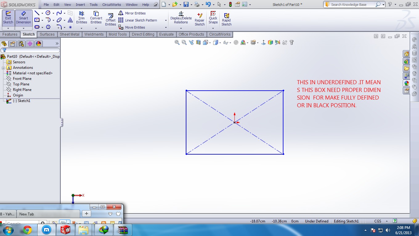

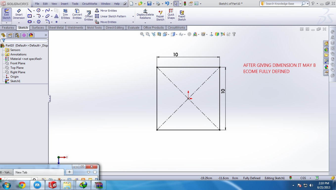

WHEN THE DIMENSIONS ARE IN BLUE COLOUR,THEN DIMENSION ARE NOT FULLY DEFINED,OR YOU MAY NOT GIVE IT FULL DIMENSION.
SO WHEN YOU CLICK ON DIMENSION THEY COME IN EDIT MODE,AND YOU CAN CHANGE IT EASILY,AND AFTER GIVING ALL DIMENSION IT MAY COME IN BLACK POSITION .THEN IT IS FULLY DEFINES .
