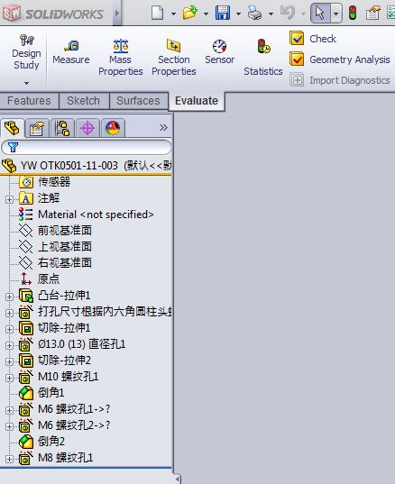

Hi There,

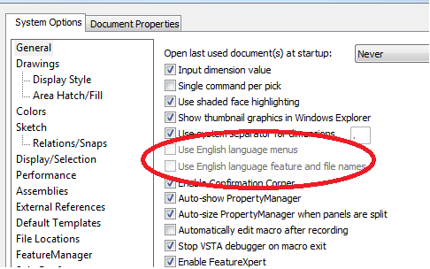

The drawing and part file are in Chinese language; the feature names and every thing. How can we change the language of features? I tried to change the language in "system options". But the language changing icon is in suppressed condition!!!!!!

The modeling was done in solidworks someone else in another language, it will not be possible to do the conversion automatically. Click on the resource name, press F2 and change manually.
You should take a macro like this.
http://www.eng-tips.com/viewthread.cfm?qid=250003
Save out the part as a step. Now open the part into your template and run featureworks on all the imported bodies if necessary. You should now find the part is converted into your language.
