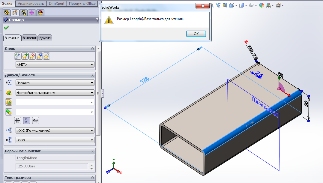

How change dimension in Toolbox component. always "read only file" Viktor 25 Feb, 2013 06:11 PM I want change dimension in double click, but Solid aways tell "size read only" 9.png 3 Answers Aled J Taylor Answered on 25 Feb, 2013 09:51 PM You need to create a 'custom profile'. The help system should tell you how to do this. Viktor Answered on 26 Feb, 2013 02:59 PM But i want to do it with Toolbox profile. So it is not possible? C Bd Answered on 26 Feb, 2013 08:49 PM After you have created the weldment. Expand the structural member component Open the sketch Modify as required You are done This does not alter the weldment profile in Solidworks and you can reload and revert back anytime
