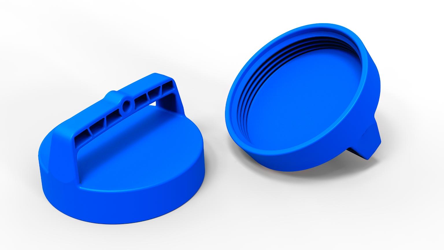

Attached is an image of a cap I designed with a 6-4 7°/45° 2B American National Buttress Thread.
Modeling the thread was needed for 3D printing, and fit testing with an existing object. If the part were going straight to production, I'd have skipped modeling the thread, and just applied a callout on the drawing.
