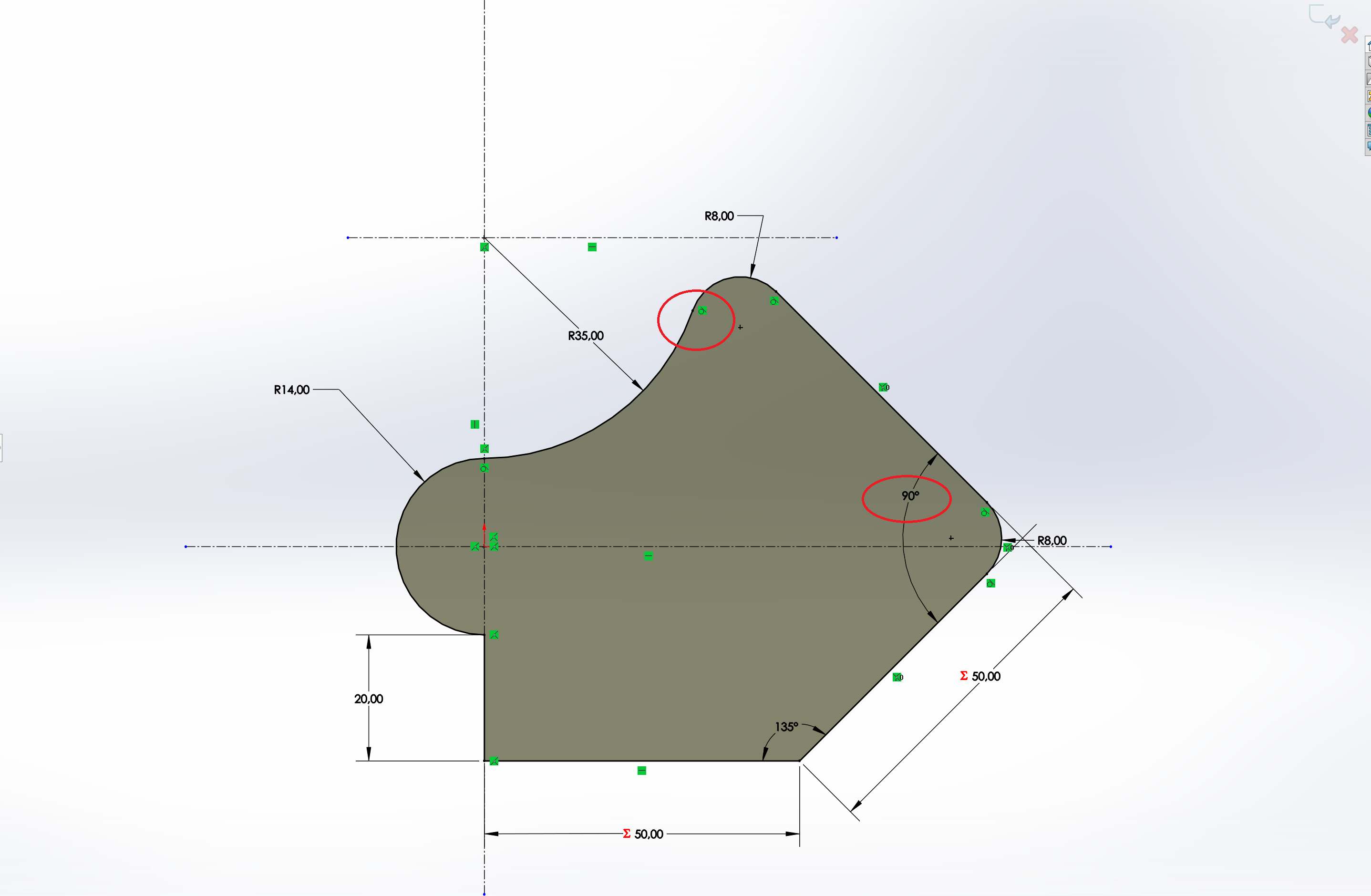

How to correct the fault in the part ?

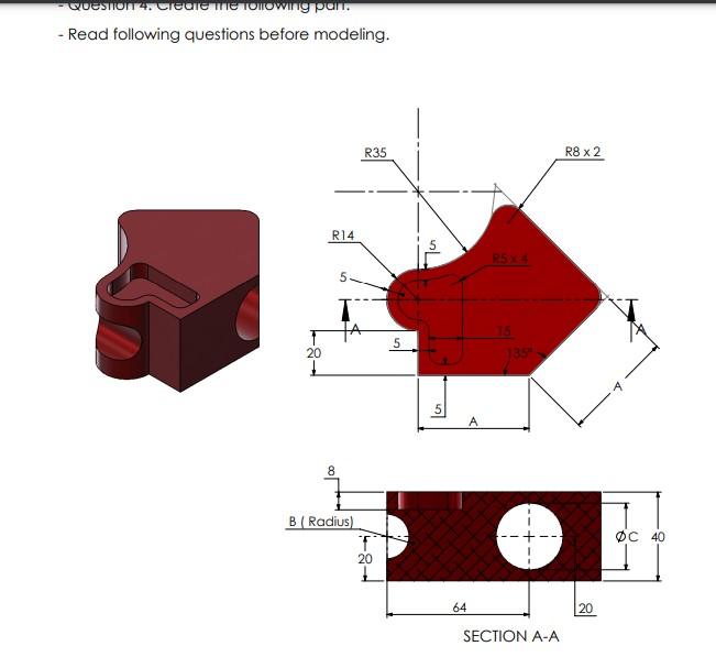

Hello, I need someone please to verify the mass of the part cause when i did i didn't find it matches with the required mass of the part , what can i do to correct my fault ?
Nb: *the problem was taken from CSWA EXAM PREPARATION 2013 .
*you will find the required documents for that : - the part .
-the 2 sheets of the part ( question 4 ) .
- the PDF file of the correction .
and thank you !!
Accepted answer
The answer is 345.94. Your sketch is underdefined. Look at the attached picture. there should not be a straight line between two radiuses, the radiuses should be tangent to each other. also specify a 90 degree angle.
