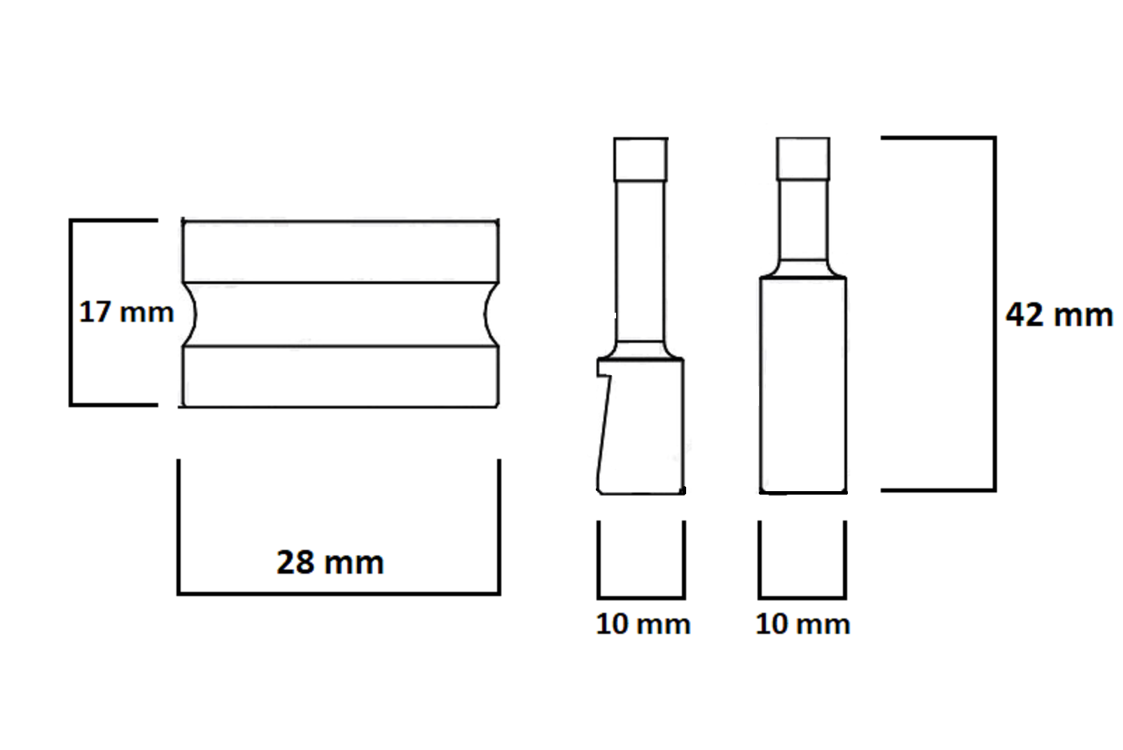

What are the punches used for? That will largely determine what material is suitable for their construction.
What 3D printer do you have? Most printers use "plastic", so your options may be rather limited. The ability of the printer to recreate these images at the desired scale is somewhat unlikely, but it all depends on the printer.
A program like Materialise Magics will cut your image designs into the STL files. But, the quality/resolution of your images is terrible. Before using them, I'd clean them up with an application like Vector Magic. Or, just redraw then at a higher resolution.
I'd also not work directly with STL files. I'd do the work in a CAD program like SOLIDWORKS. I'm sure other CAD programs will also work.
The task is pretty easy, but without details, nobody can complete it. How deeply will the images be cut into the punches?
Do the images need to be mirrored first?
Will the stamp make a positive or negative image?

thank you guys i sould of been more clear marijauna is legal here where i live and i press THC pills and would like to produce my own custom pills stamps using 3d printer to print just the removable punch and dies.
I am pressing pure THC isolate from medicall marijuana and mixinging it with pharmcitical binder and filler microcrystaline cellulose and pressing it in a machine called a TDP 1.5 like in photos attached it produces a max 1.5 tons into a very soft powder for less then a second never striking solid service

1.5 tons and plastic do not go together. Especially if this product is being eaten. It is too easy for the plastic to fracture and leave pieces in the product.
Also, there is the issue of being "food safe". Most 3D printed parts are quite porous and impossible to clean adequately. Metal is a much better/safer option.
0k then a cnc engraver? same software design though?
