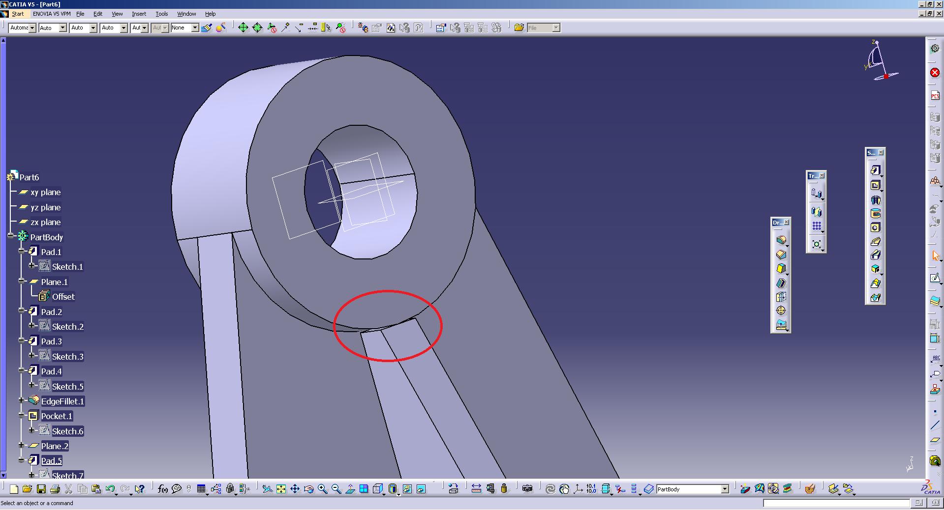

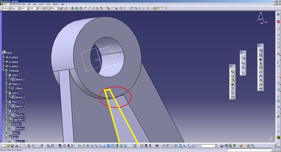

How do i do this? Chitransh Agarwal 15 Sep, 2014 06:59 PM As you can see my rib is not upto the cylindrical portion i want it extended up to it but since i was working in the perpendicular plane i was not able to do that Sorry but i am a newbie, Please help me Untitled.png 1 Answer özgür kesebir Answered on 15 Sep, 2014 07:54 PM Just extend your pad sketch. Like yellow one. large.png
