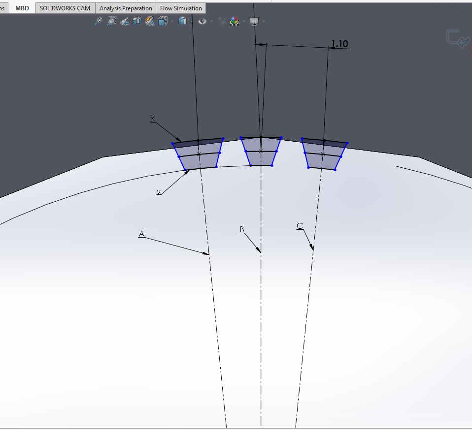

I'm working on a sketch where I have some of the dimensions and relations. Inorder to find the other dimensions I need to use variables with the relations I have in my hand. How do I do that in SOLIDWORKS? When I try to add a global variable for the dimension I need to find, they ask me for the dimension along with the variable name.
From the attached image : 1. arc X should be twice arc Y
2. Distance between line A to B = Distance between line B to C = 1.1mm
3. Line A,B,C are Perpendicular Bisectors of arc X and Y (corresponding arcs)
I need to find the dimensions of arc X and Y using solidworks. Please help me with this. Thanks in advance.

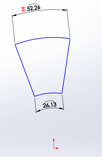

1) place dimensions on both arcs (image 1)

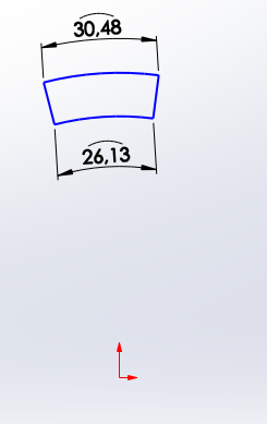

2) Select one of them and specify it as dependent on the other (image 2). After which it will appear as a calculated dimension (image 3).

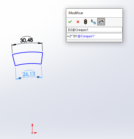

Note 2: to make a dimension (arc, for example) depend on another, you must select it and place a "=" sign in its value and then write the equation (for example: = 2* .... the dimension of the other arc, which you must select for its name to appear)
