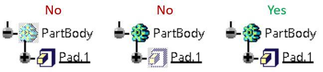

I am hiding a part while giving constraints to the inner parts of the CATIA V5 Assembly design. But when I select the hidden outer part and click on show again, the part is still invisible and is not shown back.
Go to the tree and show all; if the operations or the main body are hidden, you cannot see it. See attached picture.
