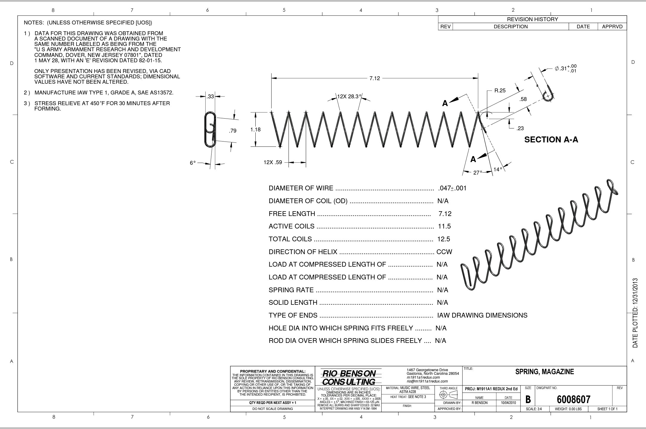

how do I get this part done in SOLIDWORKS easily ? 1pratheush prabhakar 20 Dec, 2016 04:53 AM Found this part drawing, please suggest the best and the easiest way to get this part done Screenshot_20161220-101714_1.jpg 1 Answer Michael Thalin Answered on 20 Dec, 2016 05:11 AM Swept boss. Just draw your profile then create a 3d sketch of the path you would like it to be if you're lazy use a linear pattern to seed your profile that way you don't have to draw the whole path. Good luck.
