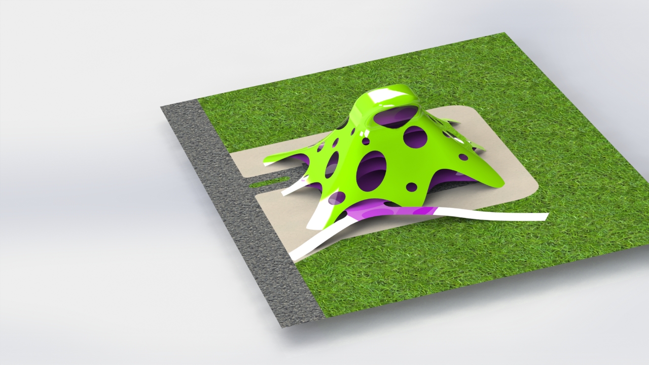

Hi, pls help for get this done. Original project is unauthorized national library by Mr. Kaplicky (https://en.wikiarquitectura.com/index.php/National_Library_of_the_Czech_Republic). I just need put some trees in scene. I found some online, but they have too many surfaces, or are too ugly :-) .Any other suggestions to get it better would be nice.
