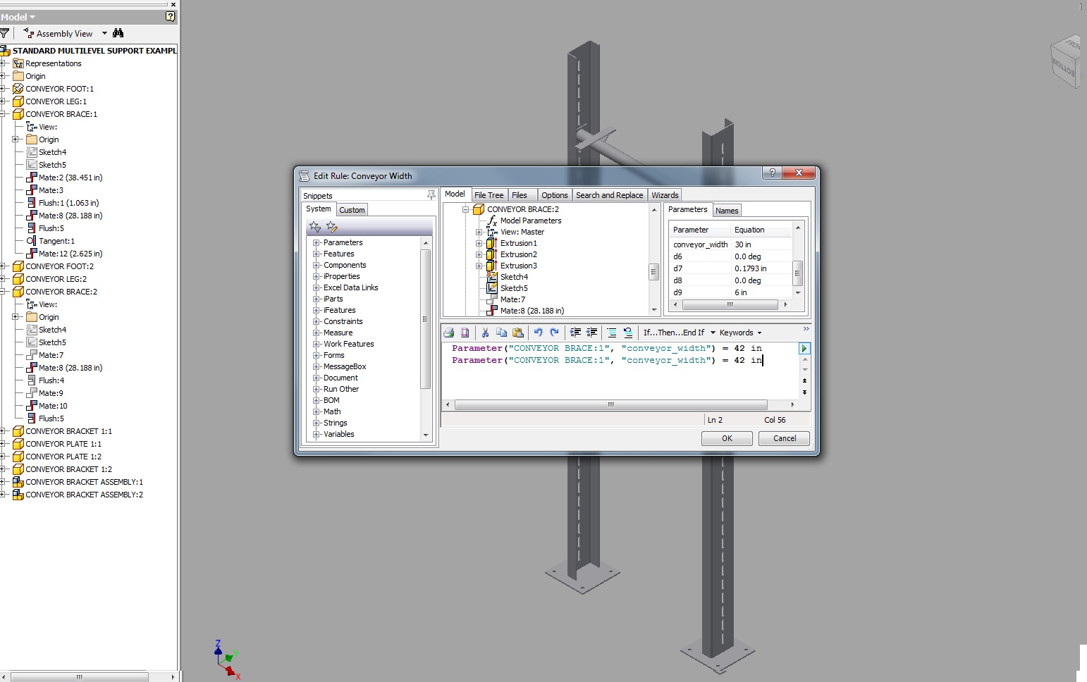

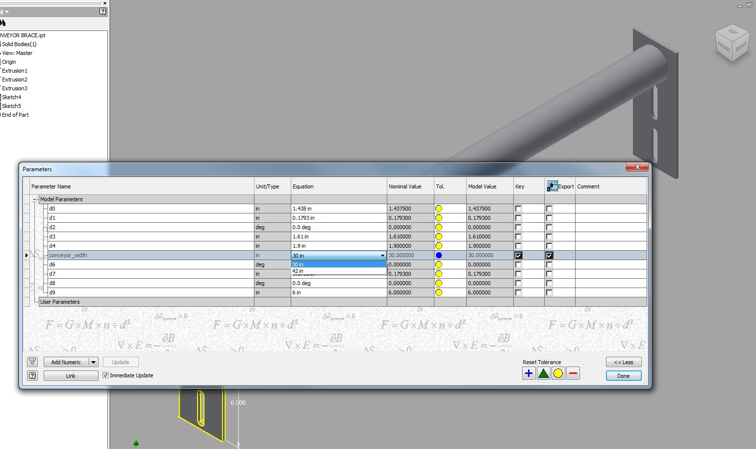

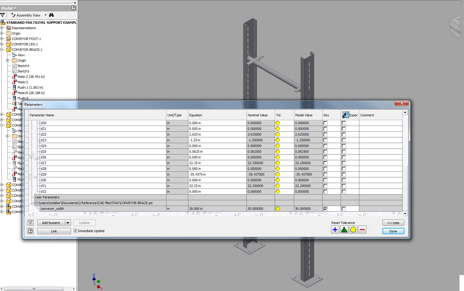

I created a multi-value parameter for a part and exported it (see "part.jpg"). I linked to it in my assembly (see "assembly.jpg") but I was not able to alter the values. I tried using iLogic but that did not work either (see "iLogic attempt 1.jpg").
Did I do something wrong or are there other ways of doing this? If there are other ways of doing this would you please provide a step by step instruction on how to do it?

If not assign only 42 instead of 42"
Parameter("CONVEYOR BRACE:1","conveyor_width") = 42
and use
'update all
iLogicVb.UpdateWhenDone = True
Hope this works.
