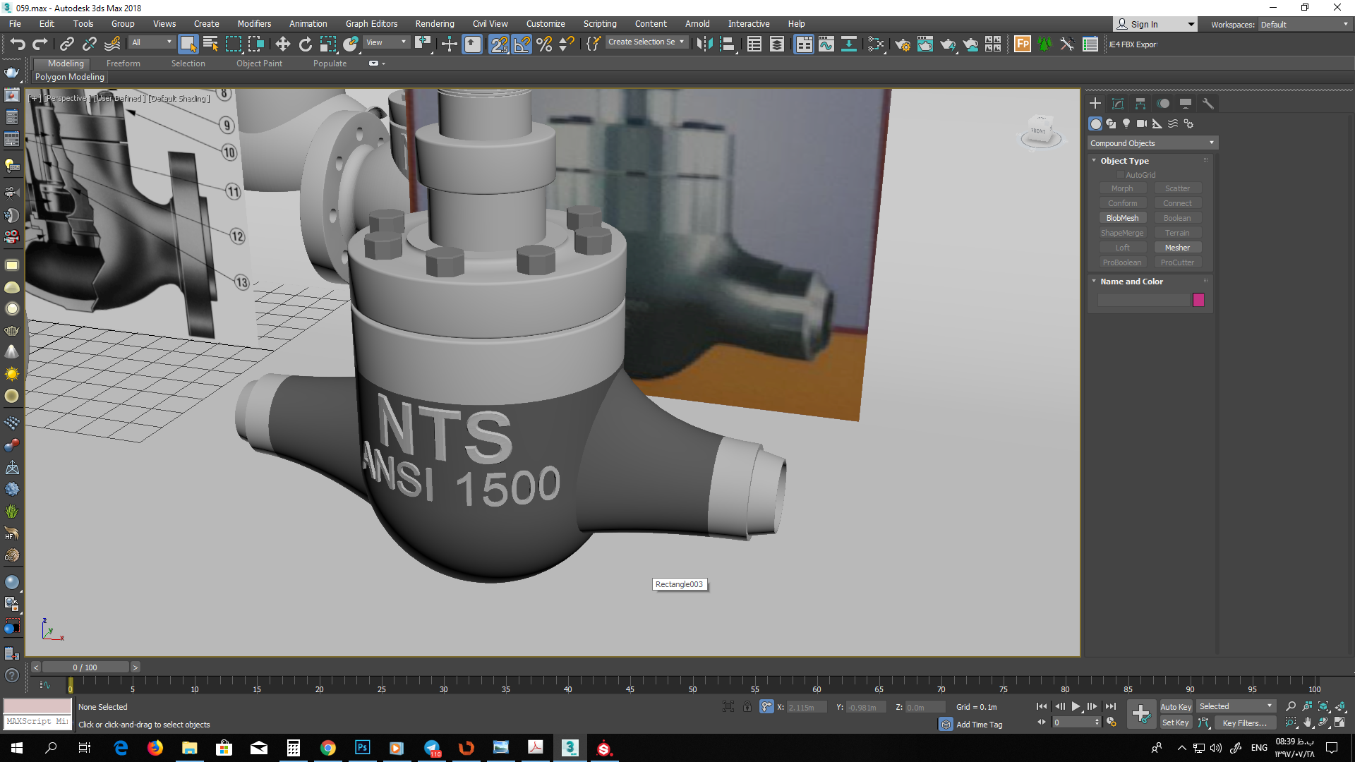

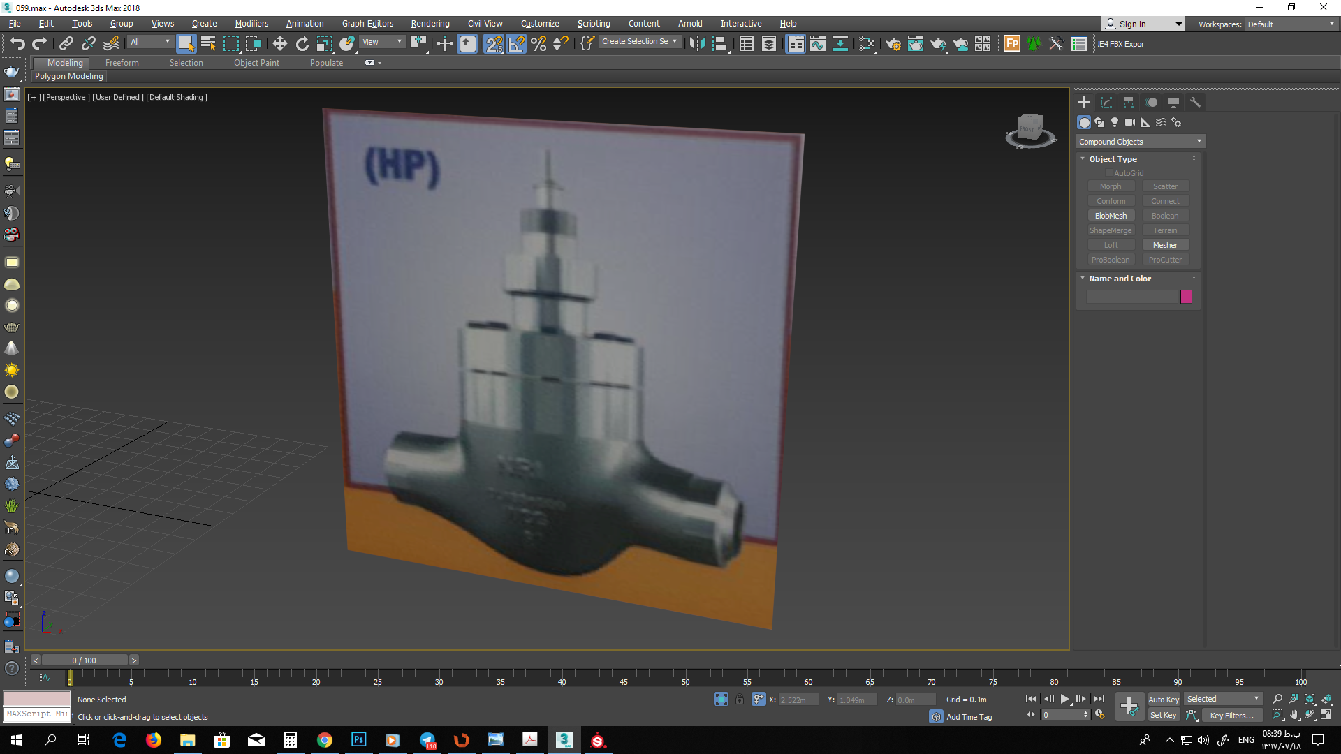

hi i modeled this valve(first pic) in the 2end pic
but i have problems in the join of hands to body you can see a line between body and hands
You'll need to add fillets, or make your lofts/boundaries tangent - somehow - to the main body.
- Revolve the Valve body profile around the central axis
- Loft the end connections.
