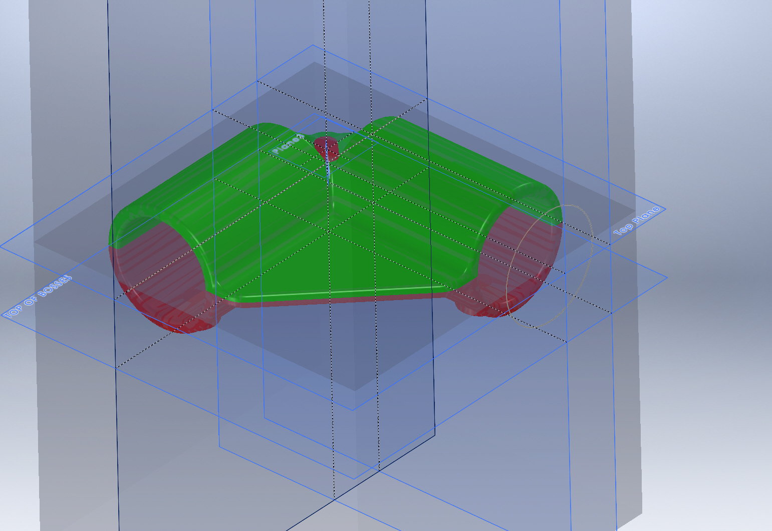

How to add core pulls (slide) to this part in SolidWorks?
I don't have a lot of experience with mold creation in SW, but all of the Tooling Split tutorials that I've researched do not show an example such as this part. The split command ends up spliting my core pull pins in half. I can knit them and end up with a solid, but I think I am missing something simple that could streamline my mold design.
Any help would be greatly appreciated!

There is an attachment. Instead of sw mold tools, I use other functions. See how I have done it.
Monika
Thanks for the time that you took to explain and complete the split.
I was struggling with SW mold tools and, essentially, ended up splitting it similar to what you did. You did a couple of steps that were shorter than the way I did it.
You were very helpful.
