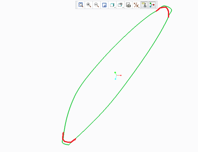

How to add fillet when a curve is drawn through points???
Can someone help to draw a fillet at the ends of the curve which are marked in the red colour of the attached screenshot, part file of the curve is also attached.
Thank You,

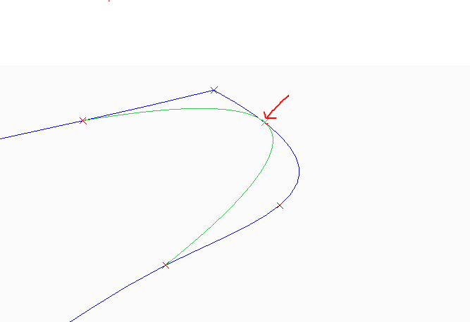

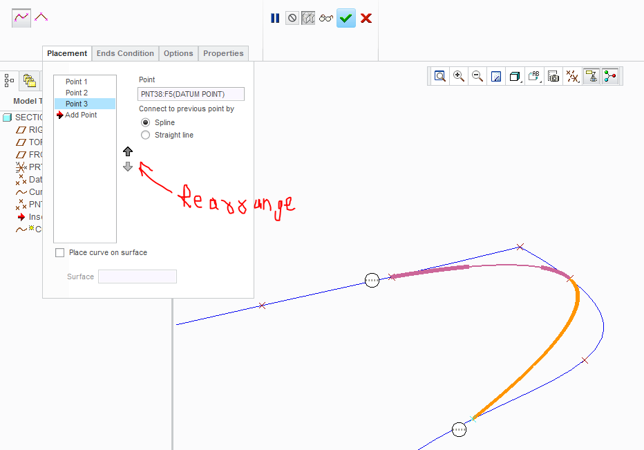

Hi Naveen,
I have some suggestion for you,
Step 1. Just create new point at the center('s).
Step 2. Edit definition the curve. Omit the remaining two (Both point side of new point) points in curve command.
You might got help from rearranging the points.
see the attached Creo2 file.
