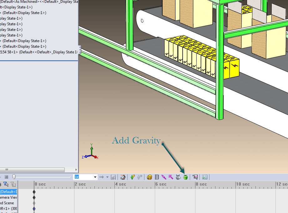

how to add gravity animation raghulan 21 Oct, 2012 05:20 PM i don kno how to give gravity animation 12.SLDASM 1 Answer Gary Maltby Answered on 22 Oct, 2012 05:25 PM In your assembly start Basic Motion or Motion Study and select the icon that looks like a green apple(see attachment). Select the item that you want to apply gavity to and then select the X,Y, or Z direction for the gravity. Add_Gravity.jpg
