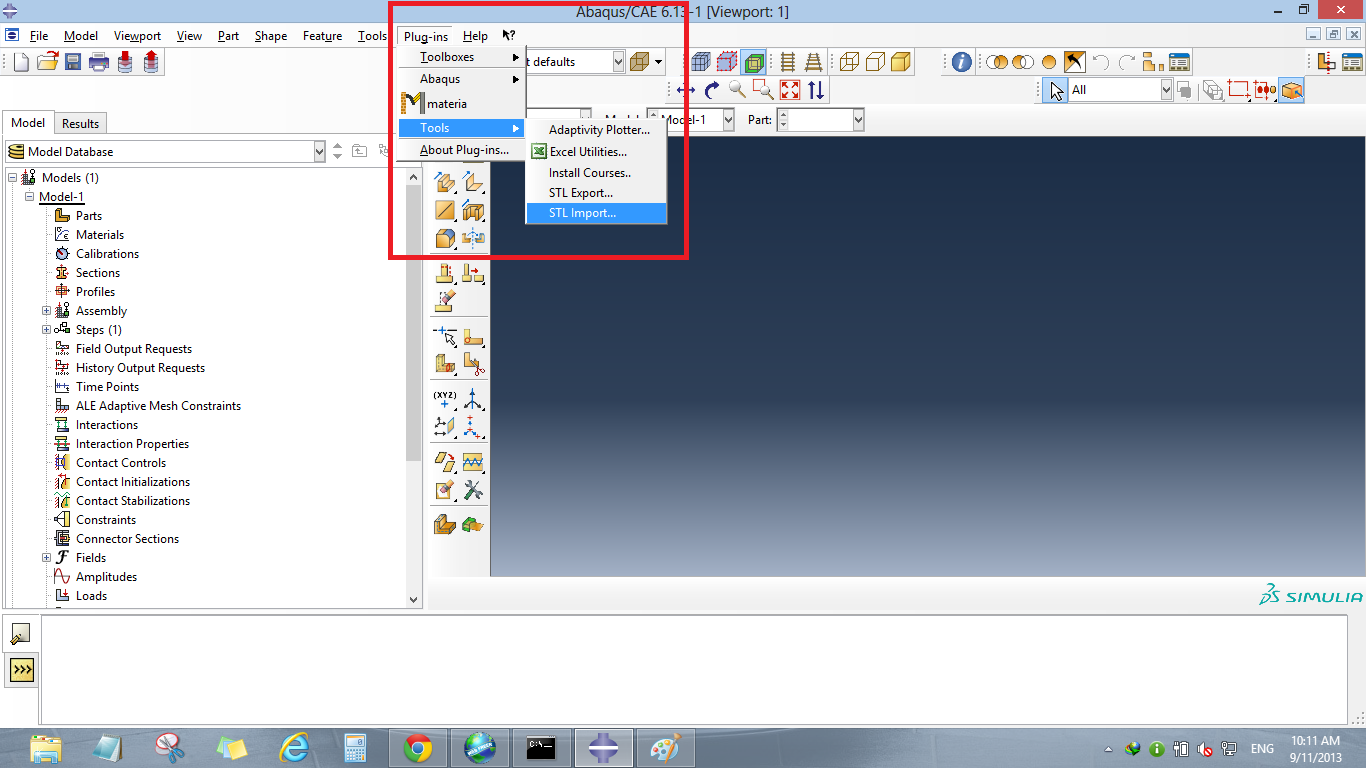

My goal is to run static analysis on the original STL part file but somewhy Abaqus requires to define sections?

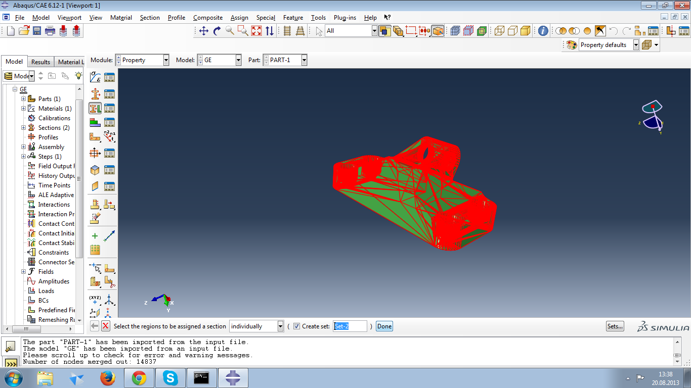

for assign a section for a model you first should go in "property" Module Then as shown in my attached picture you should select "assign a section" and then "click on you model" and "set a region" under model appear(above status bar appear) then Ok.
finished.

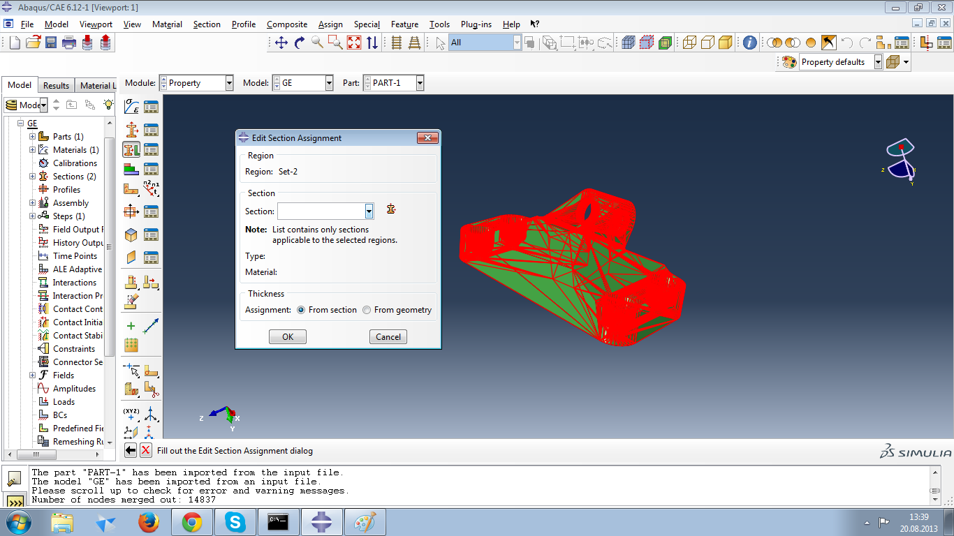

Unfortunately it did not solve the problem, because i had already done that ("create instance"). It is just that selecting part for GE and beam are completely different. After selecting the part it does not let me choose my Section.
