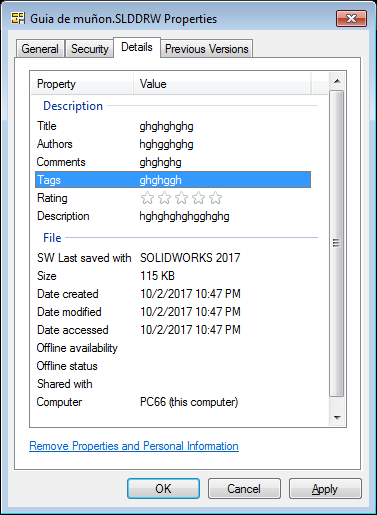

Perhaps there's some other metadata that can be added to the file after-the-fact, I see a spot for 'authors' in windows file properties (right click, properties, details tab), but I can't seem to adjust that data here at work, perhaps our IT doesn't allow it.
Here is an image of what Robert suggested.
I was able to add text to each of the entries.
Again, both options are pretty temporary. Anyone one could just delete the entries in the Windows properties, or the SolidWorks Custom Properties.
