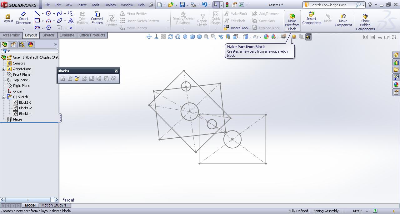

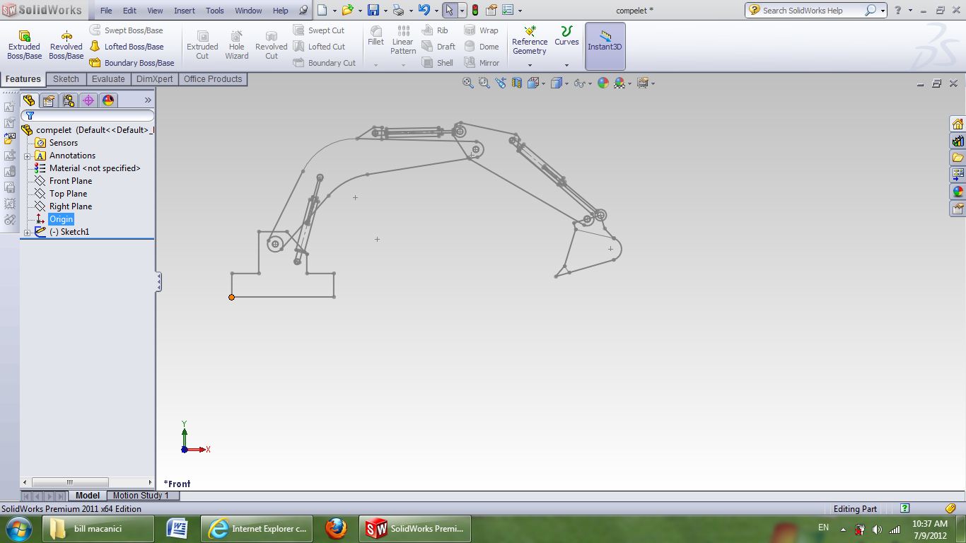

How to change "block" to part? arabim1t 8 Jul, 2012 03:35 PM the "block" file working good but I want to play "features" on them Thank you 2 Answers Sudhir Gill Answered on 9 Jul, 2012 02:33 AM Use make parts from block. untitled.JPG arabim1t Answered on 9 Jul, 2012 06:14 AM hi thank you How I can going to Assembly? Capture.JPG
