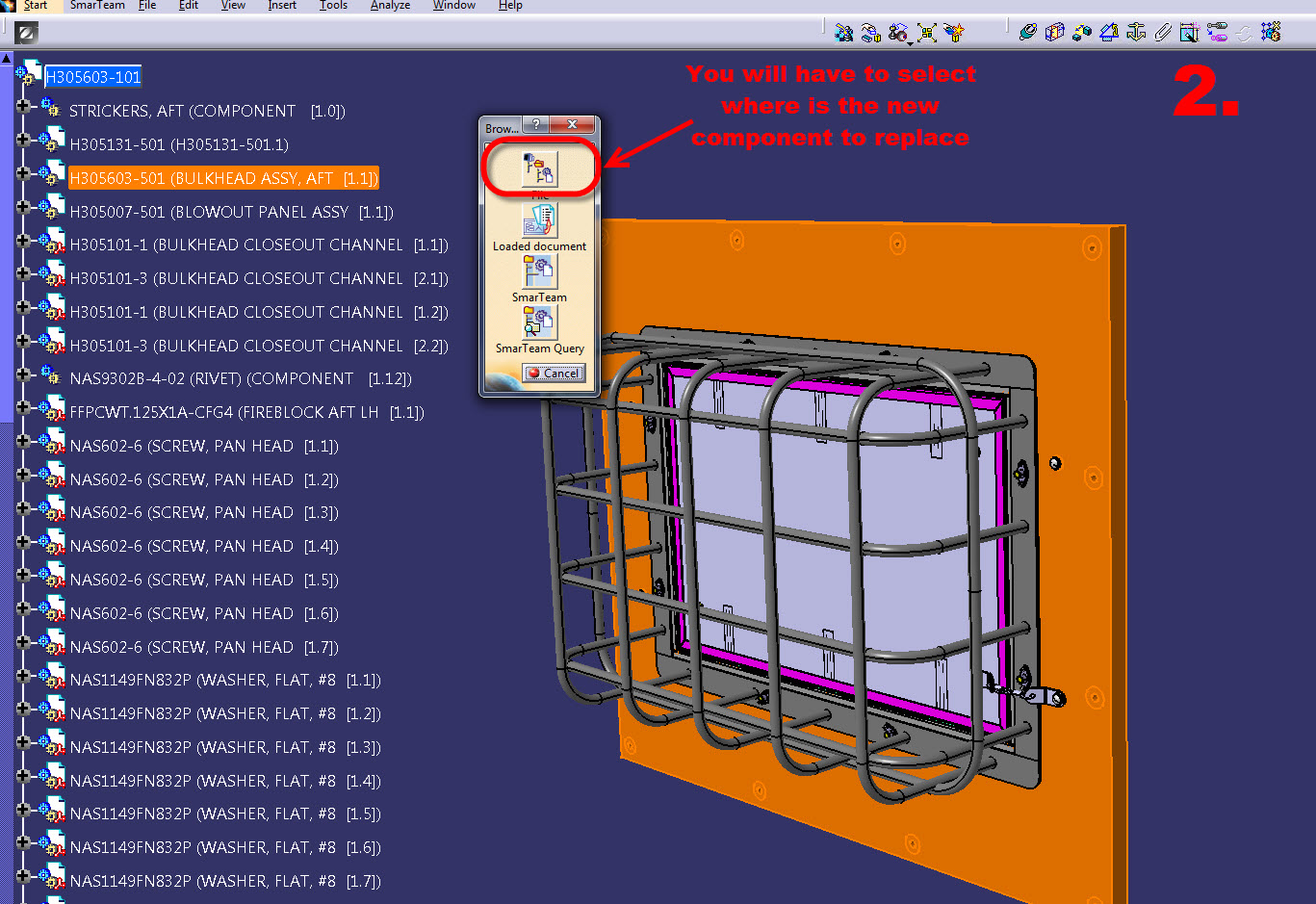

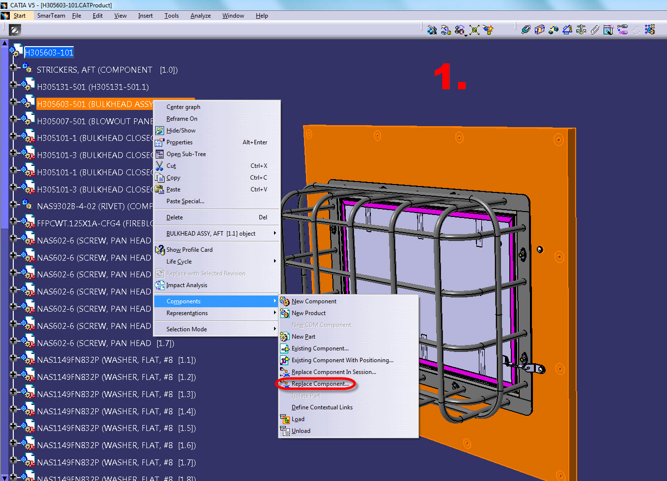

its me again friend, if my last before comment it doesn't work, try to ommit it,and try the following, if you would like to replace a component in a cat product, try to follow the following steps:
click on component inside the tree (cat product) as shown in the picture below, for example as shown in the picture below: H305603-501>right click>components>replace component, after that you can select your new component to replace.
and thats it.
