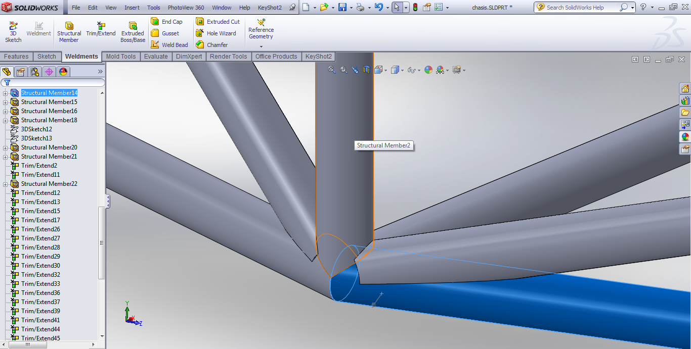

I'm drawing a frame. I assaigned some profiles to frame. Now i'm trim-extending the structural members on weldment module. I'm lost on it. I don't understand some of them intersects or not. And i don't want to over trim some members. I need to quick check for intersecting structural members. Is there anyway to do it.?
For example, i dont get easily if it is enough trimed on kind of situation given below.
