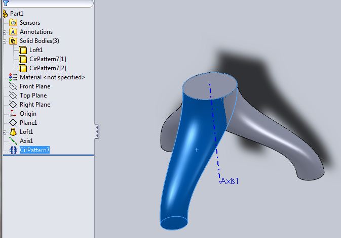

How to combine intesecting circular pattern into 1 solid

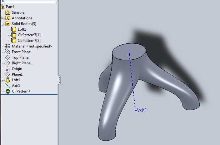

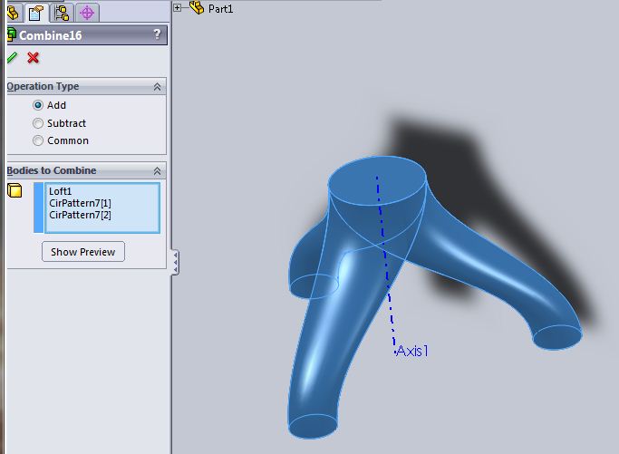

I created a loft and i used circular pattern on it, as a body, and when i try to use combine option i get an geometric error or just one leg remains the other 2 are erased

I made a similar model to see how to do it and I could not get it to make three separate bodies. Could you provide your file to look at? I made a video of the part I made. you can find it here;

I think it was a Solidworks bug, it worked when i put number of instances to 2, it also worked if the cross section isn't a circle but a hexagon for example
