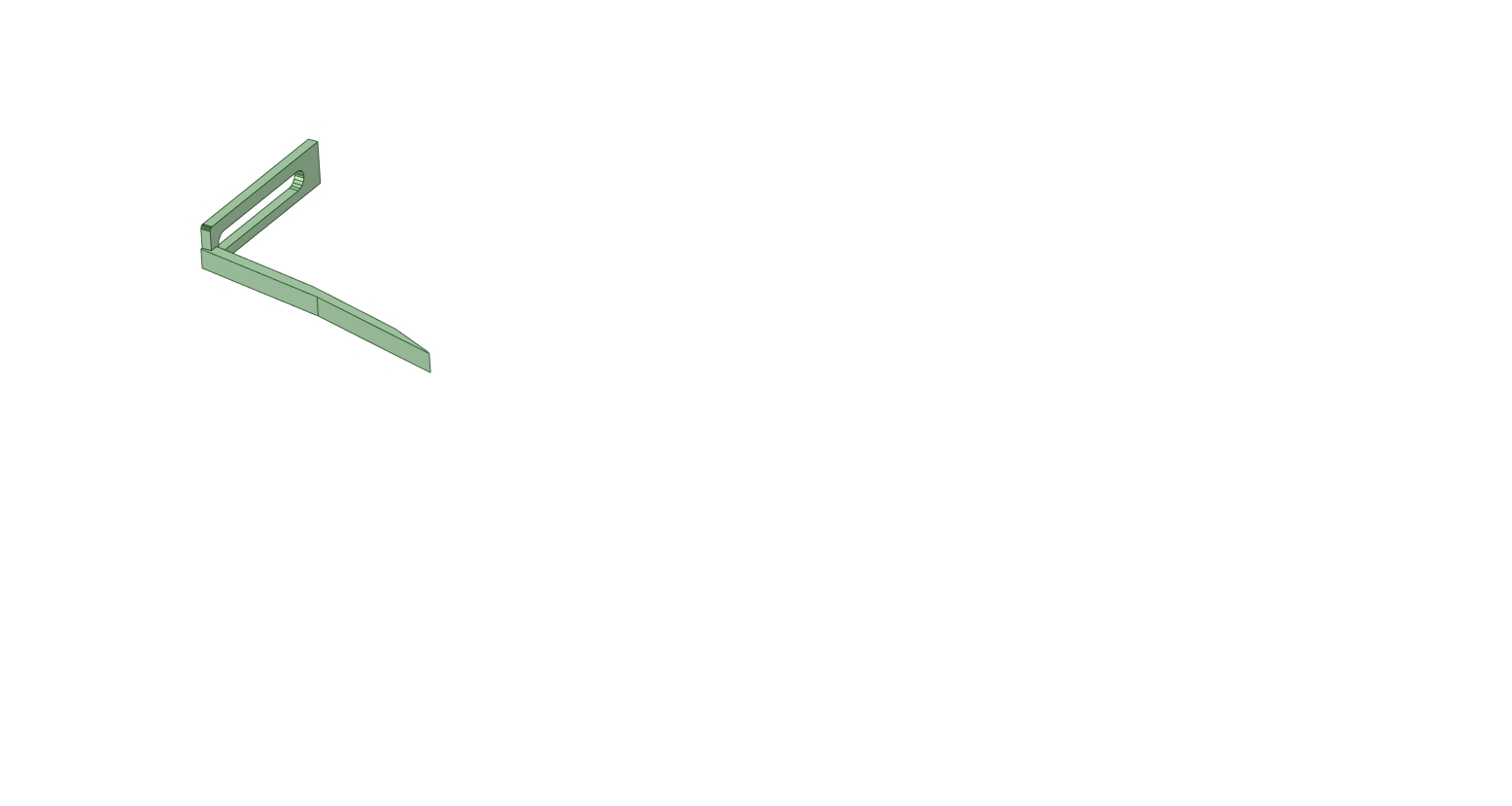

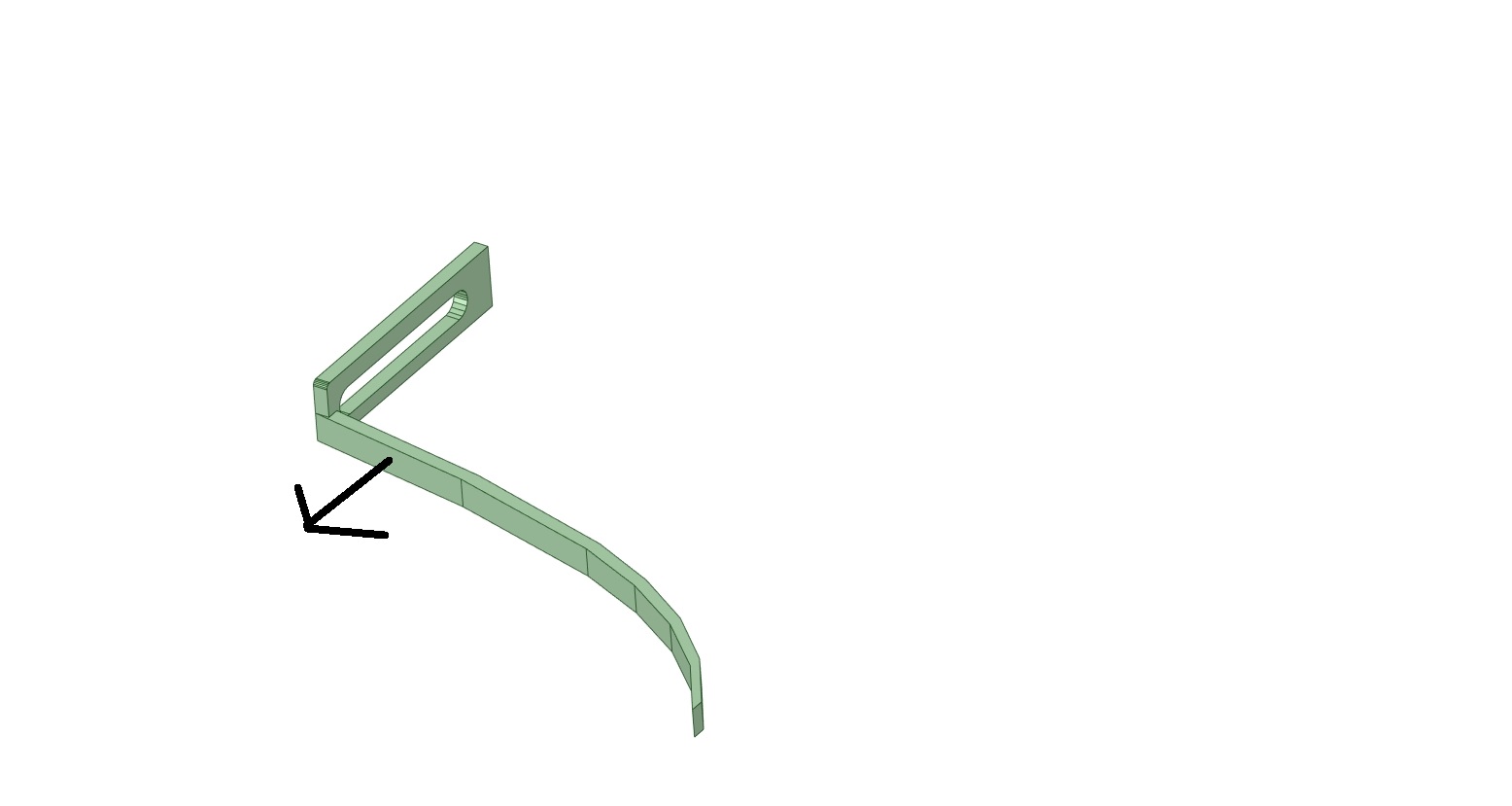

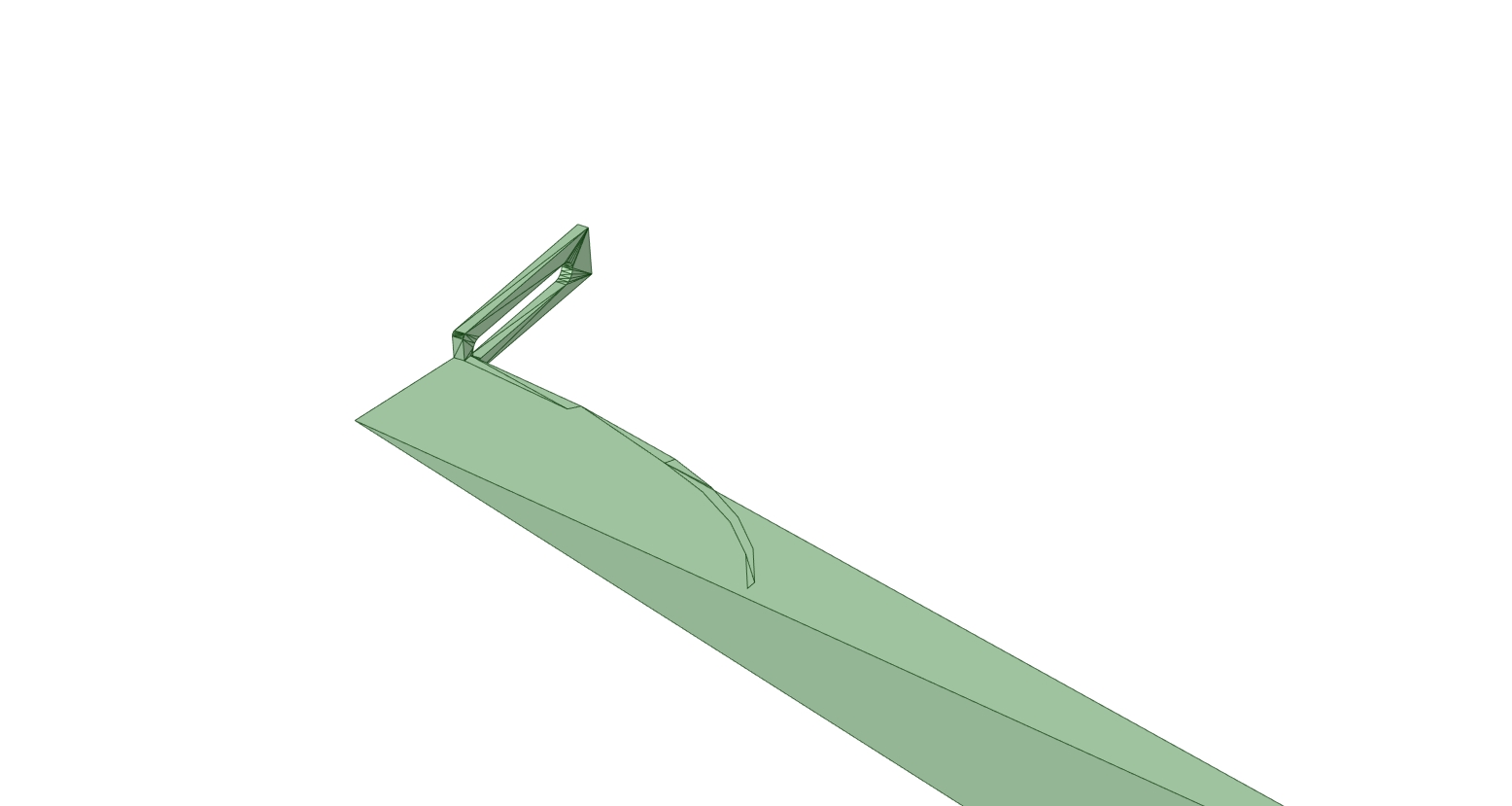

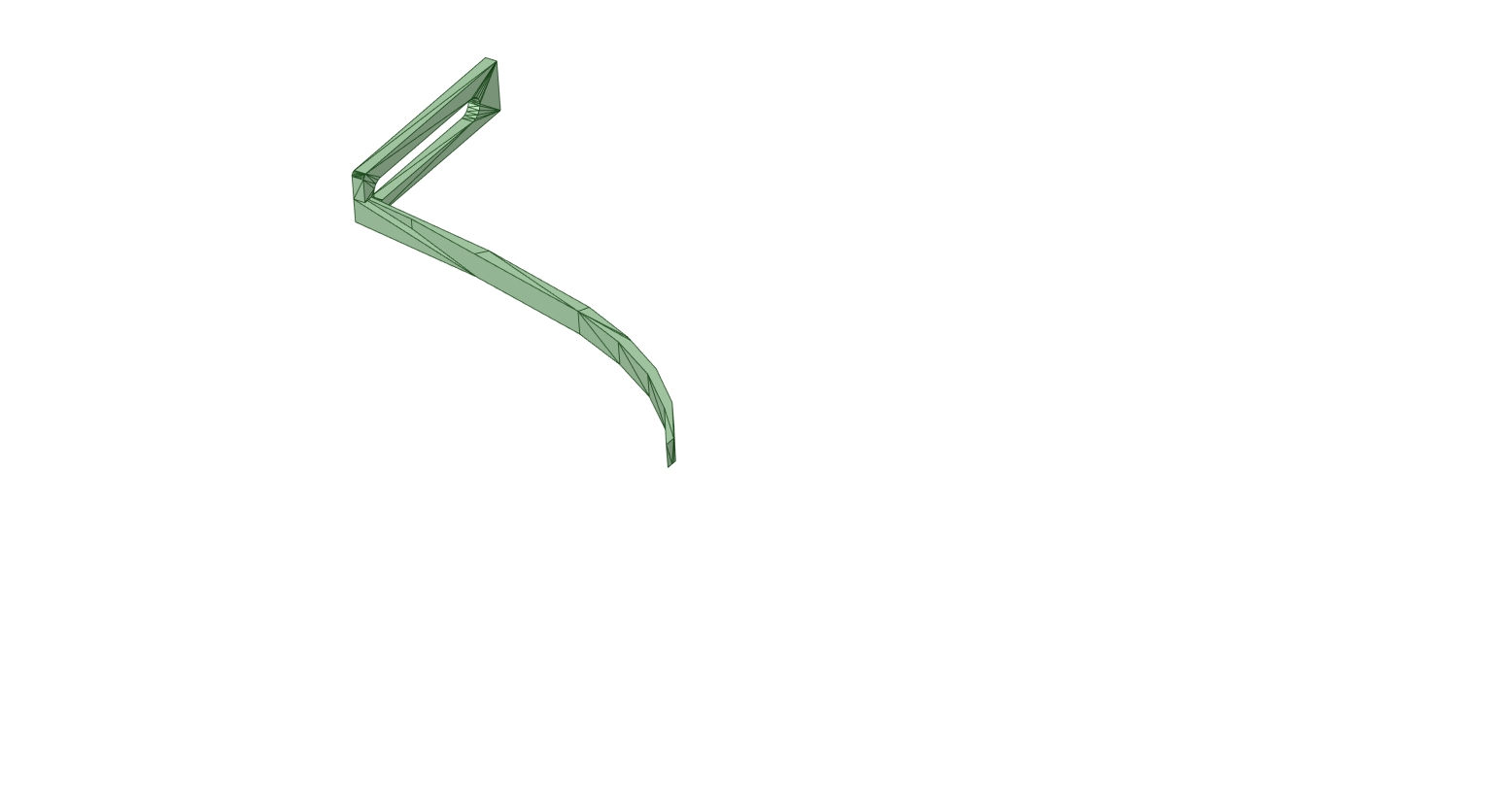

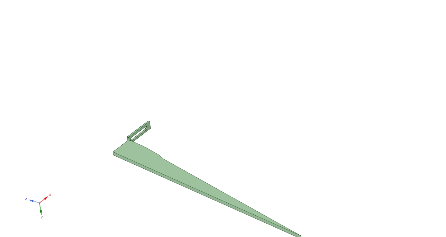

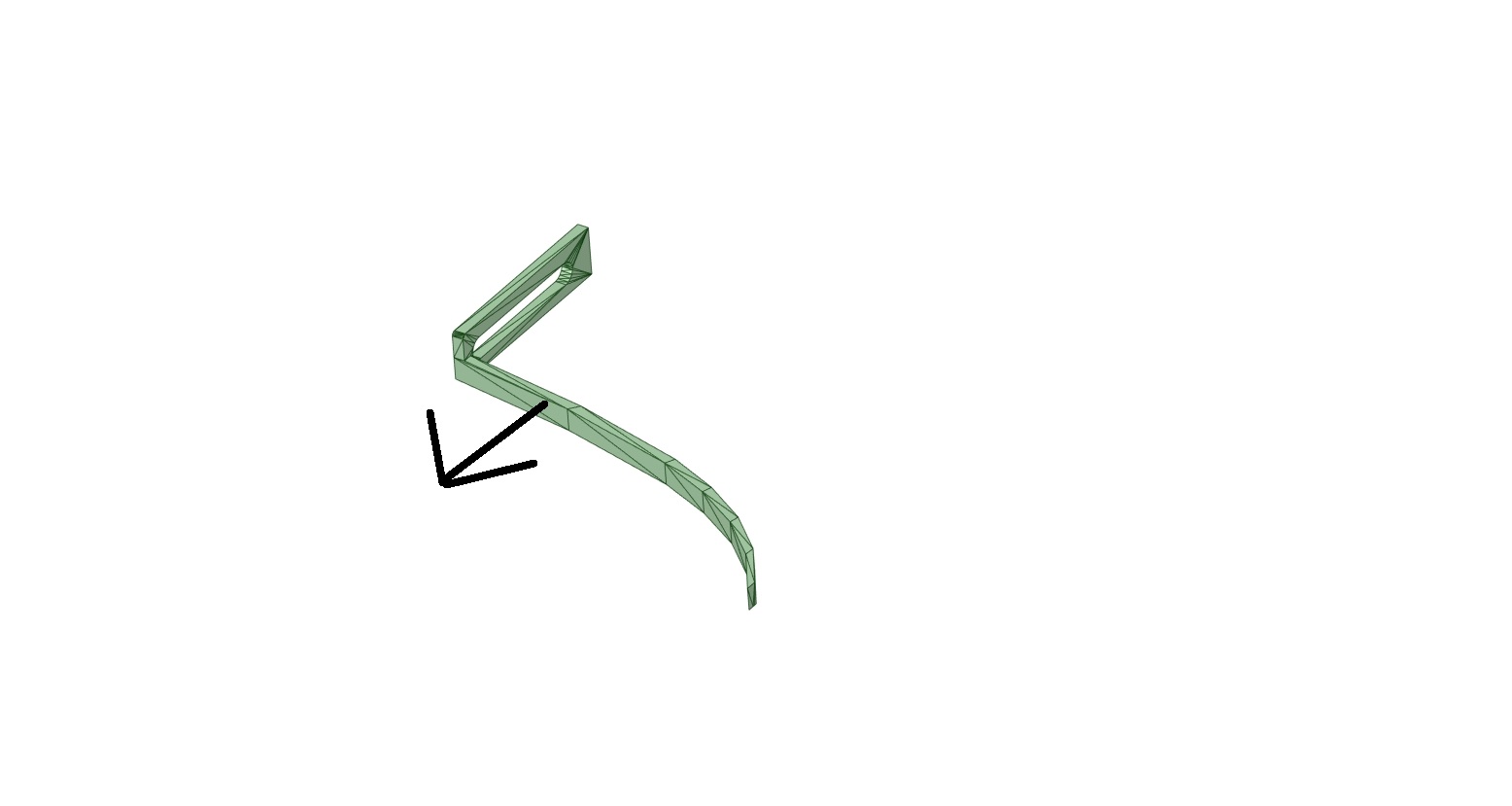

Lets look at the jpg files i attached. The 1 is merged and 2 is not merged. It can be seen by the more specifial surface boundries at 2.
When you pull the 1 as the arrow direction it looks like 11 and when you pull it at opposite direction it becomes like at 111.
When you pull the 2 as the arrow direction it looks like 22 and when you pull it at opposite direction it becomes like at 222. As you see the other surfaces are kept because they are independent surfaces than you treated once.
