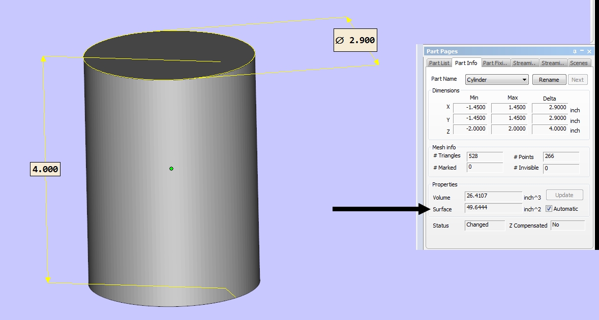

Ranjeet,
This is a simple example , but the surface area can be calculated by many STL editing programs like Magics or Meshlab.

There is a difference between a point cloud, a mesh model, and a surface model.
You have points now. Once you get them to a mesh, you'll be able to calculate surface area.
Surface models are the next step up in complexity.
