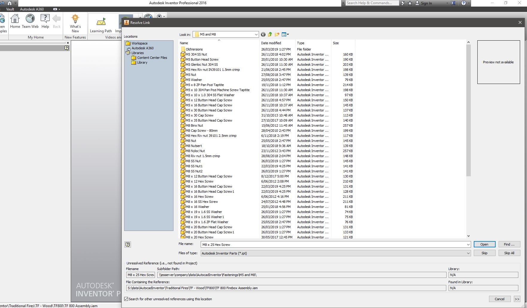

How do you add a path in a project so when I open an assembly, parts are not unresolved.
Hoi Ben,
you can add a new path by opening you project. Then you select the project where the new path is needed. Next you select " Libraries " , the right click, and add path, or add paths from files. See the attacht pdf.
Regards,
Danny
