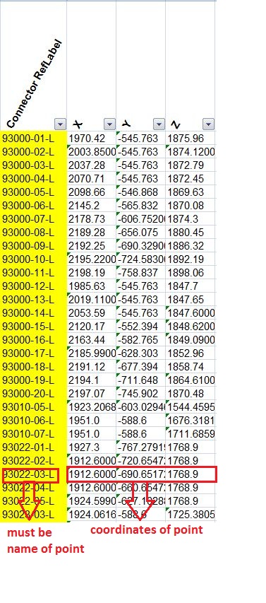

How to create a sketch based on informations of excel?
I'm trying to create a sketch using the coordinates in Excel. I have to write the coordinates of individual. is there a simple solution about that problem.
there are two attach files. I'd appreciate if you look the files and help.

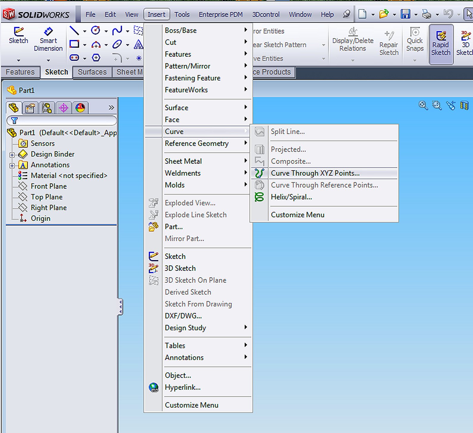

create the file with the X,Y,Z columns and save it out as a text file, in SW you can import that by selecting import, curve xyz points.
