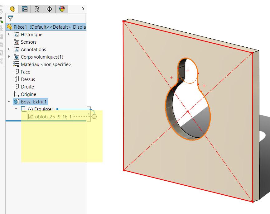

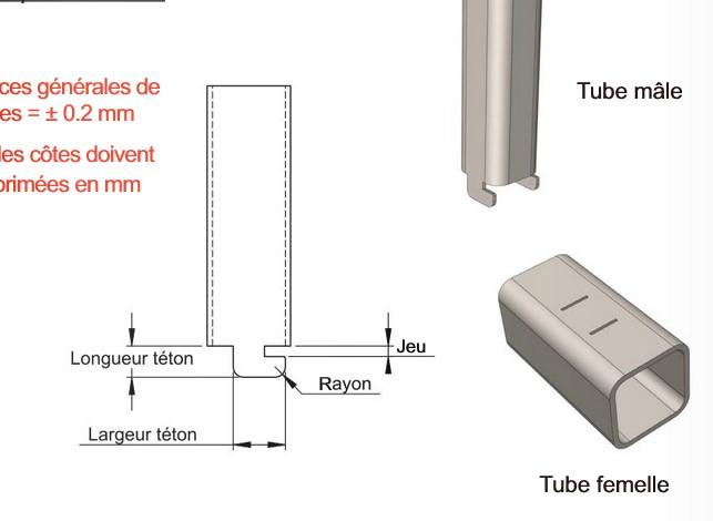

How to create custom shape for Tab and slot. lololamoto 6 Feb, 2023 03:05 PM Hello, is there a way to get a custom shape for the tab and slot, like the drawing attached? Thanks Anchor Tab and slot.jpg 1 Answer Roger Couture Answered on 12 Feb, 2023 08:04 PM Customize your cutouts using the "sketch blocks" in the cutout sketches. Group your sketch blocks into a folder and name them for quick recognition. blocs.jpg
