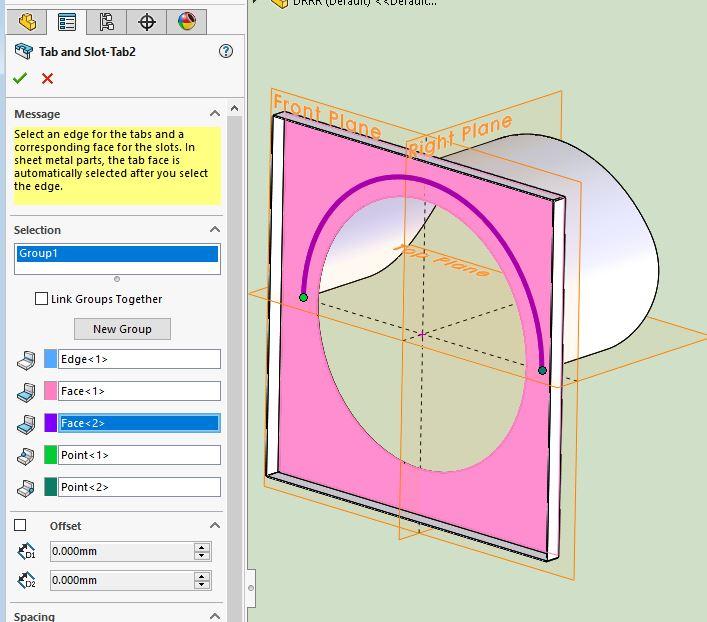

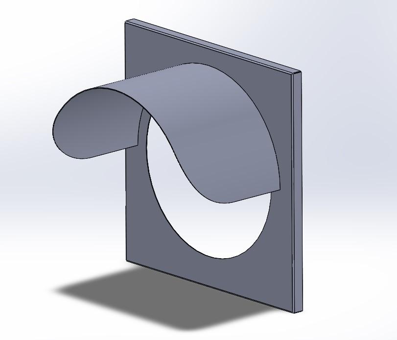

Tab and Slot Problem. Naveen Jangid 13 May, 2024 04:55 AM Can't seem to apply tab and slot joint between the two Base-flanges. I don't understand what the problem is. If I change the sketch of Base-flange2 to a straight line, then it works. Please take a look at the recorded video. Screenshot 2024-05-13 102425.jpg RECORDING.mp4 DRRR.STEP Accepted answer J. Riend Answered on 15 May, 2024 04:20 PM Try stepping thru the example. 1. pick edge, 2. pick outboard face, 3. pick face of cylindrical object. DRRR-1 Tab and Slot Feature.JPG 1 Other answer J. Riend Answered on 14 May, 2024 05:47 AM Seems to work okay. DRRR-1.STEP DRRR.SLDPRT
