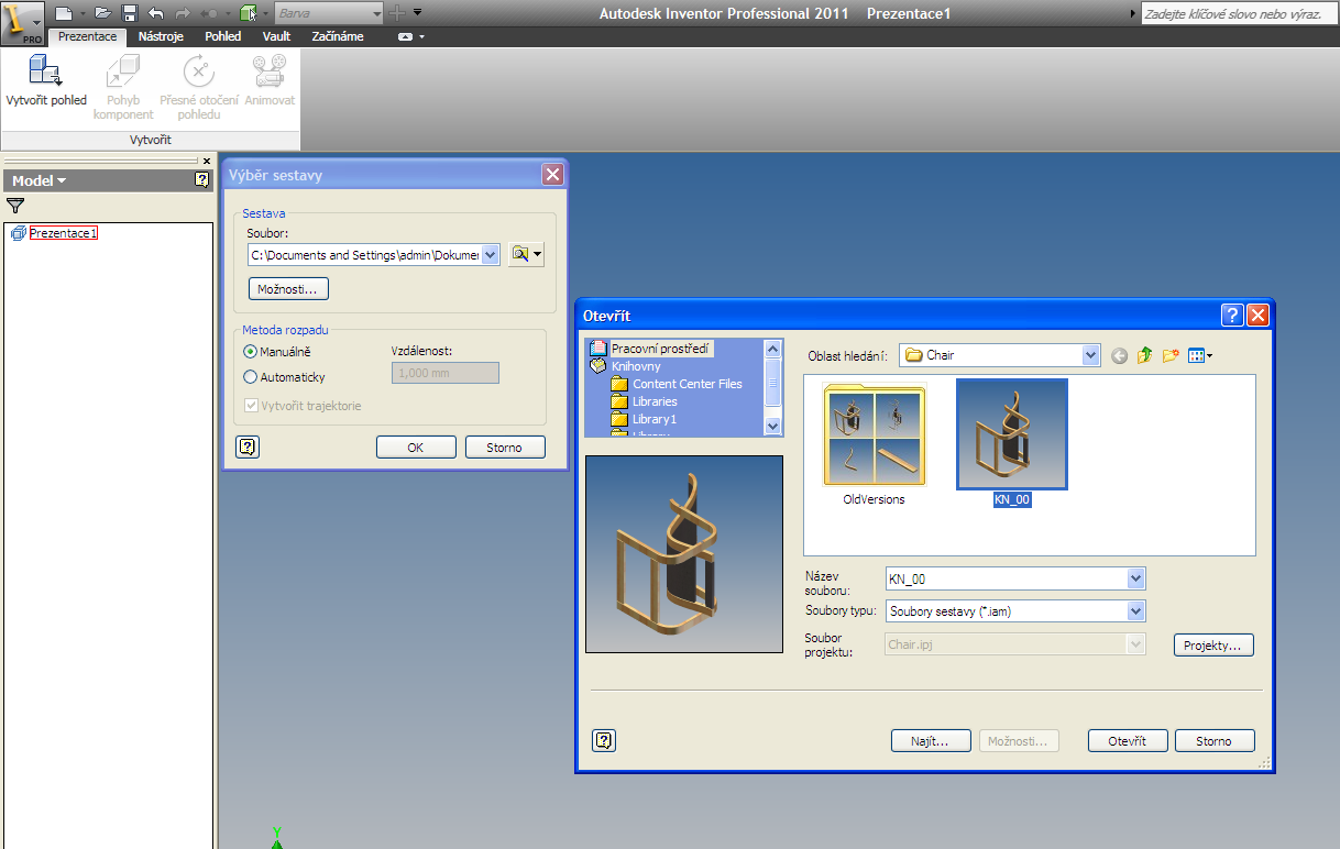

New menu, you can find out the default files as the new part (. Ipt), assembly (. IAM), Drawing (. Idw), also presentation (. IPN). The presentation is very necessary to have created assembly, from which you can then do a "meltdown". In a presentation, see Create View-> Select the file and report design view representation to be used when creating the view presentations. (Image.1)

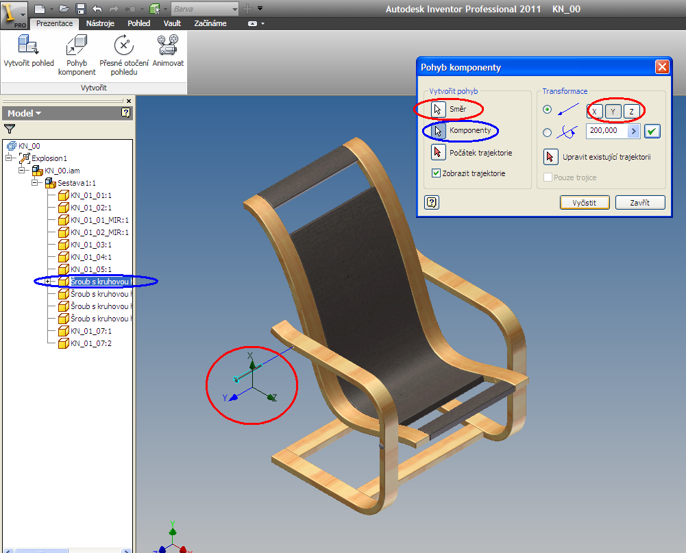

Another offer is the ability to create an exploded view of a model with the addition of manual movements or set automatic distance and visibility trajectory. Movement components may be regulated by using a function of direction, the beginnings of the trajectory, transformation, View trajectories.

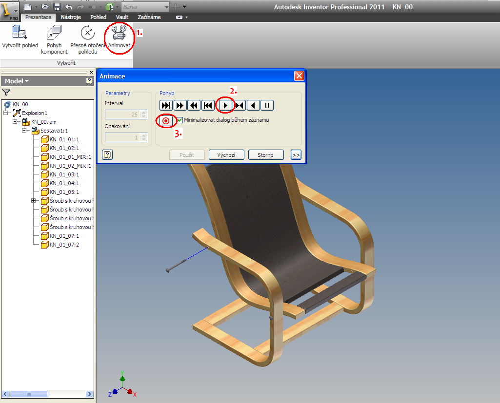

If you need a break-up record on a media file, you must use the animation settings in your browser presentation and dialogue in a task sequence (Image. 3).
