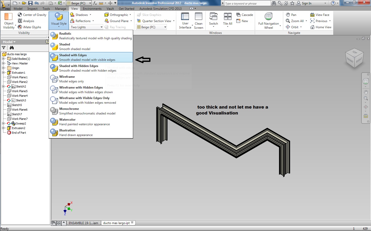

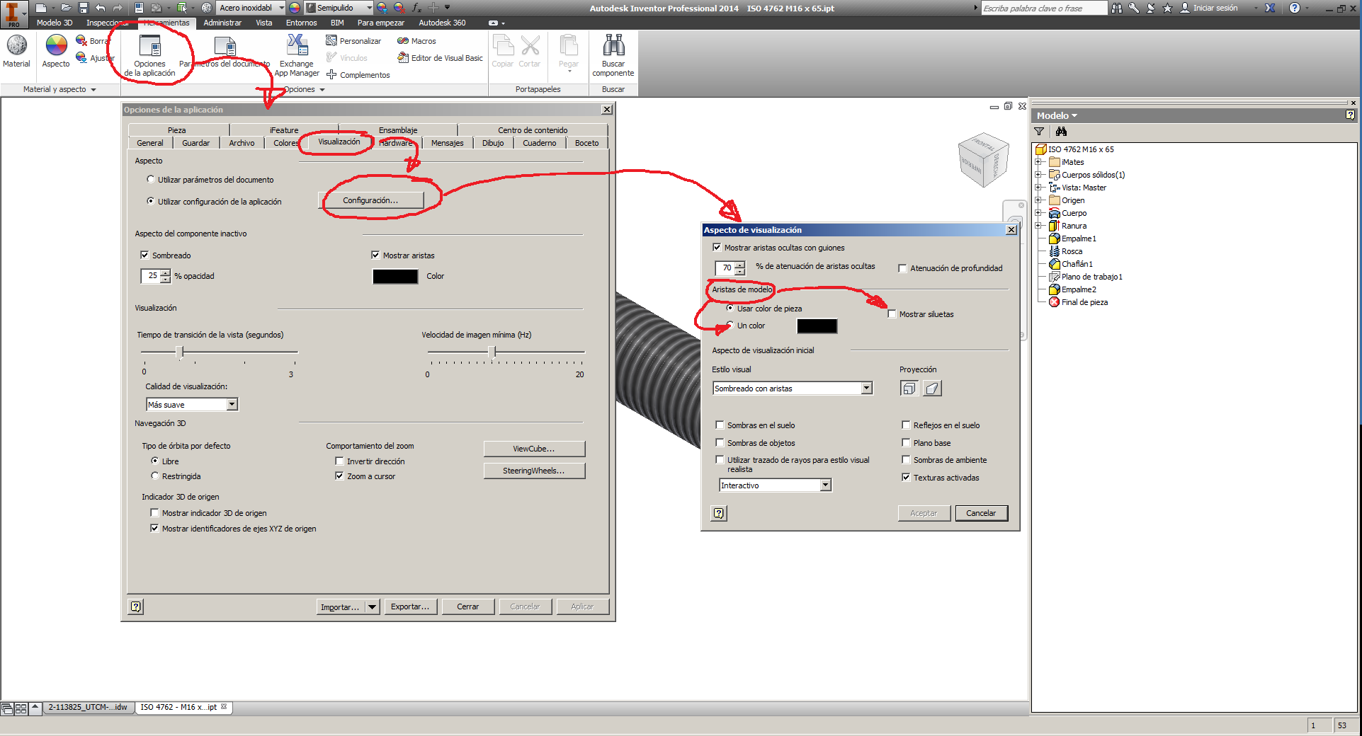

How to decrease the thickness of the lines in inventor? yeicCAD 15 Jan, 2014 01:46 PM when I open a 3D drawing inventor and I put the option to view "shared wit edges". lines of the edges are way too thick and not let me have a good Visualisation. as I can reduce the thickness. grasias. Sin_título.jpg 2 Answers Yuse Answered on 16 Jan, 2014 07:45 AM Try the menu of the attached image. ARISTAS.png yeicCAD Answered on 16 Jan, 2014 01:11 PM gracias, me sirvio
