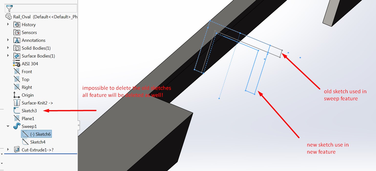

Hello, I'm trying to get rid of some old sketch, but If I delete it, all feature will be deleted as well, even when the sketch is no more in use in the feature tree.

It means there is still relation to old sketch in your latest features. For ex. you have created sweep1 feature using plane 1 as reference. But if plane 1 has reference to Sketch3, then you have a reference trail. So if you try to delete Sketch3, you will have a domino effect. Try to move Sketch3 down the model tree, when it can't move it below a specific feature. That's the feature which has reference to sketch 3.
Tools - Relations - Display Delete

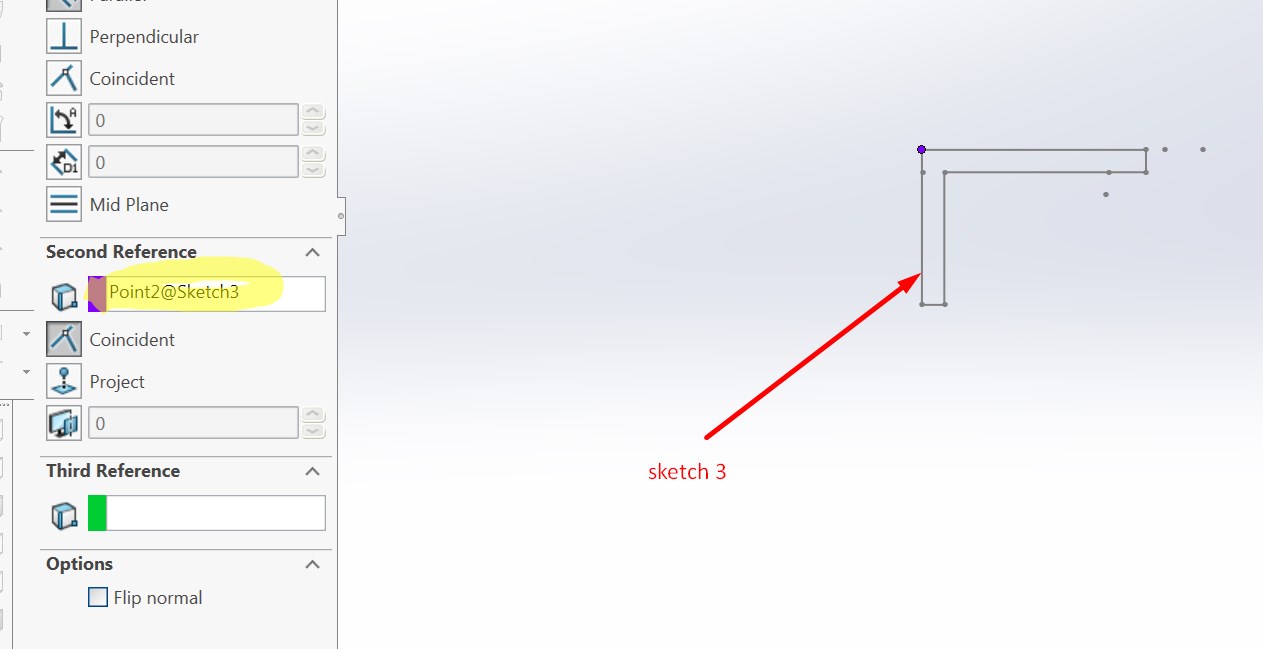

Here is the screenshot for better understanding

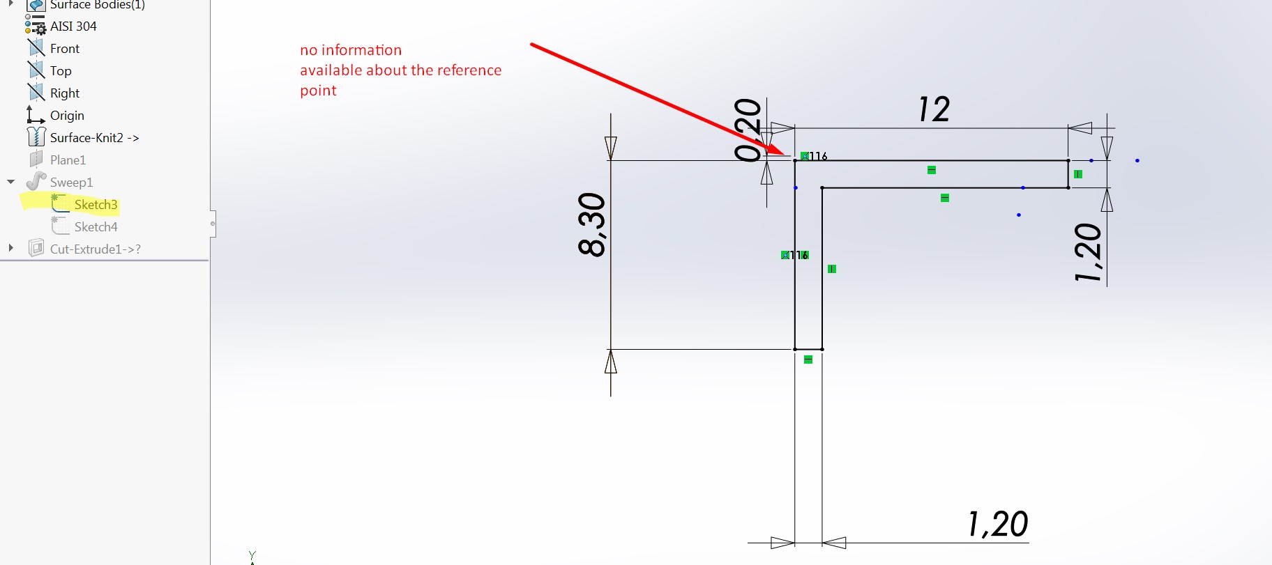

It seems that the problem is due to a reference point included in the sketch3 used into the plane1.
But how do you find out "point2@sketch3" inside sketch 3? There is no information on sketch 3 regarding this point!
