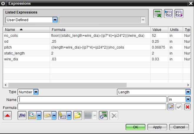

I'll suggest making a template spring and driving it with expressions IF you ever plan to make an extension spring again. Then it's simply a matter of opening the spring, doing a save-as to your new part no and modifying the expressions. Taking that one step further, making it deformable gives you a spring that can be parametrized when loaded into an assembly.

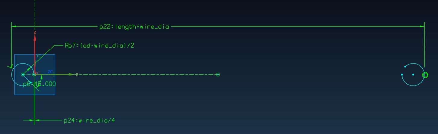

If you just want to make a spring... drive these distances with a dimension between centers instead of the expression. (see "extensions_loops_length")

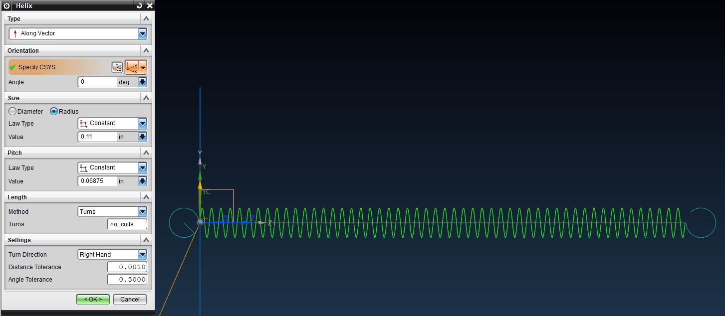

Then you drive your helix (see "helix")

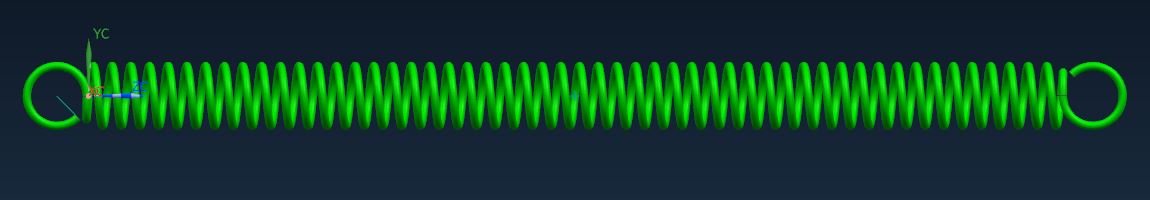

A couple of bridge curves later & a swept tube (see "finished spring")
Parameters for creating a master spring (see "paramaterized_ext_spring")
