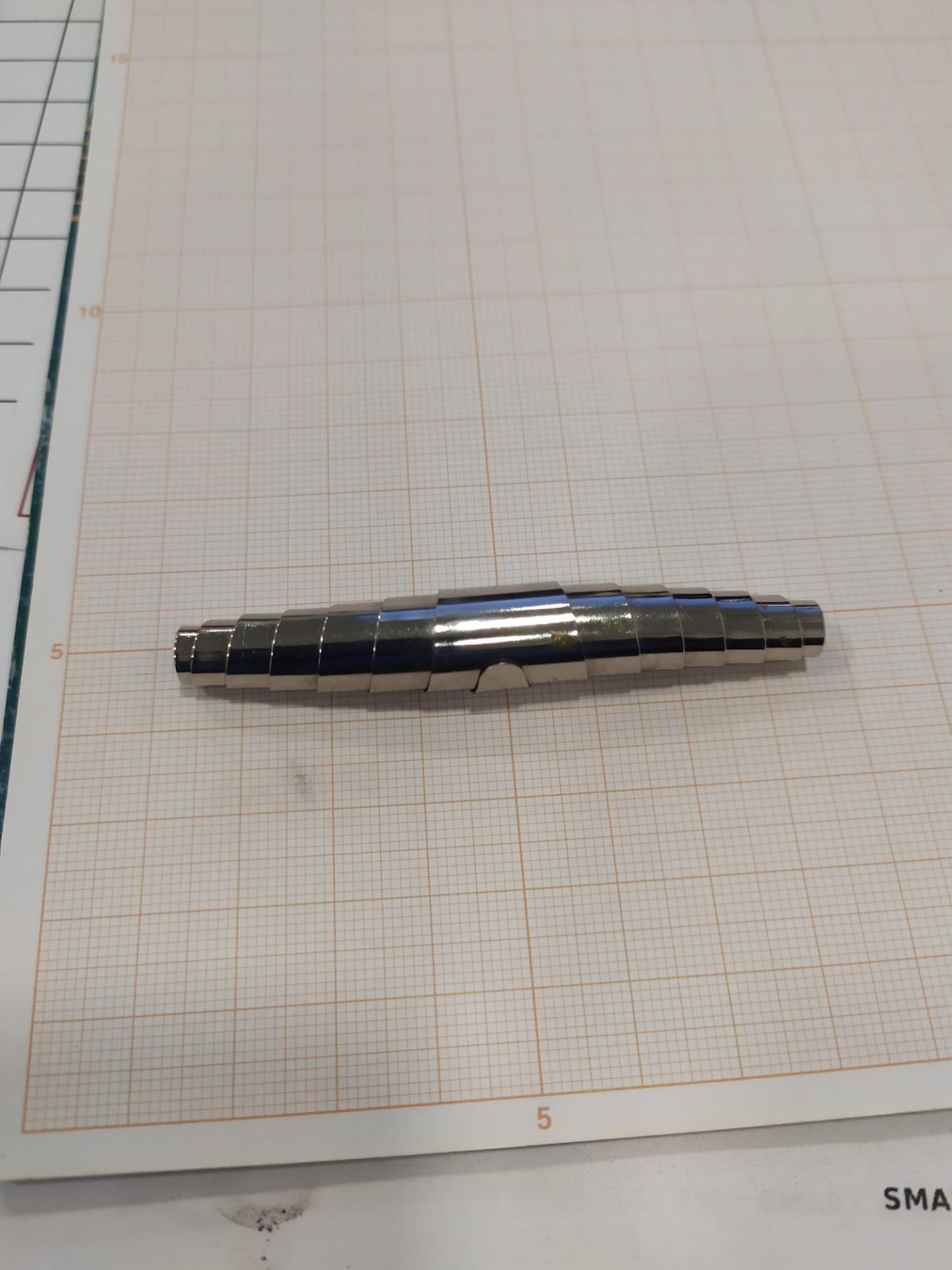

I need to make a 3d model of a volute spring as attached picture.
Can anyone give me any tips on how to do it, or get me one they've done before.

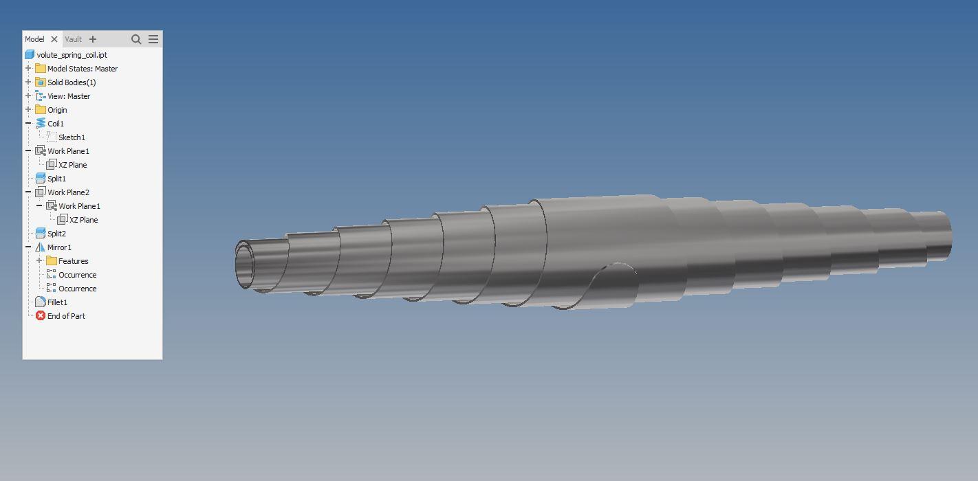

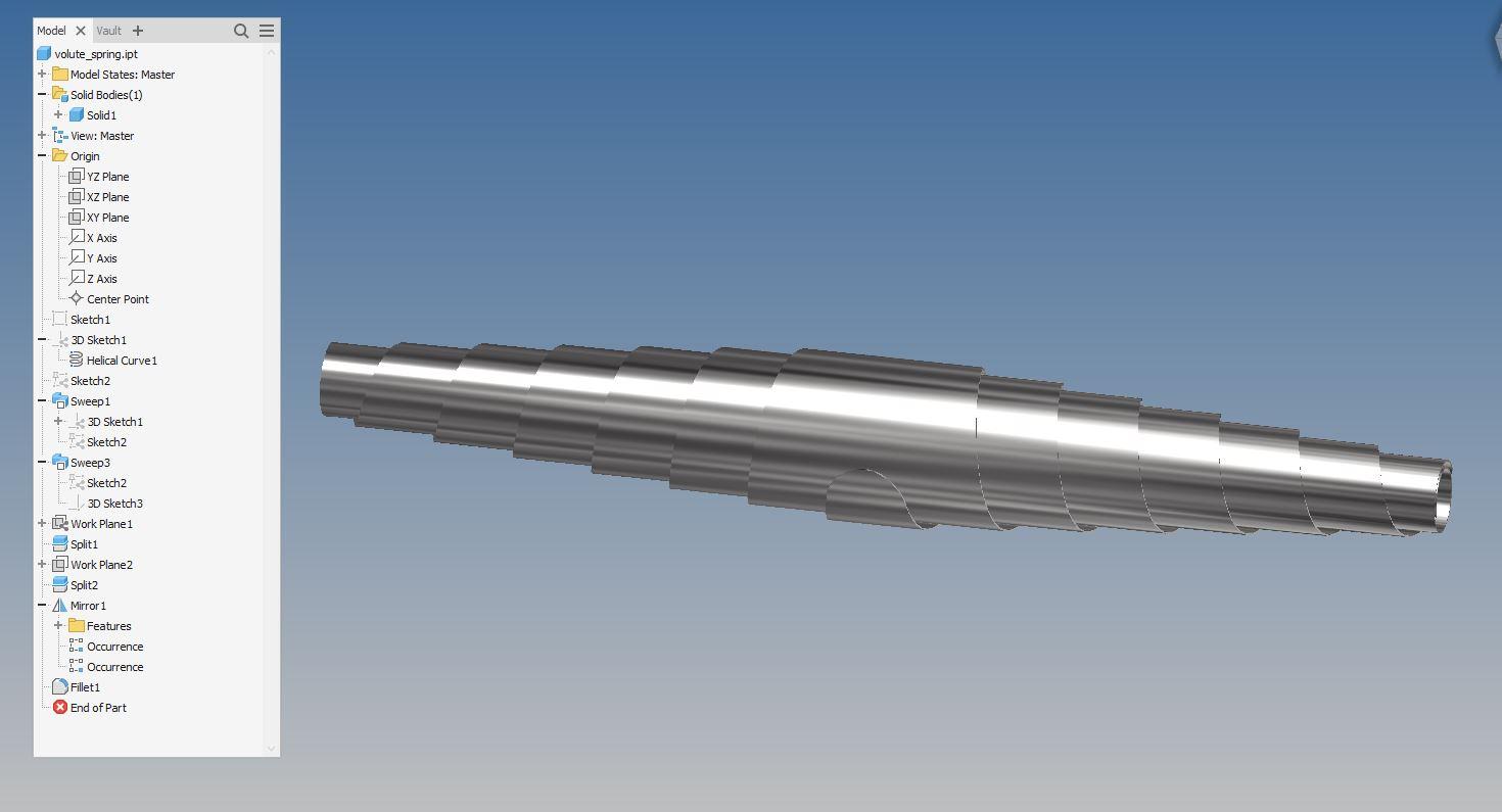

Create a tapered helical curve in a 3d sketch. Sweep a square profile along this sketch for one side of the volute. Trim the ends as required and then mirror it for the other side. I had trouble with the the square profile overlapping the pitch of the helical curve and had to join several separate sweeps to produce the full volute.
