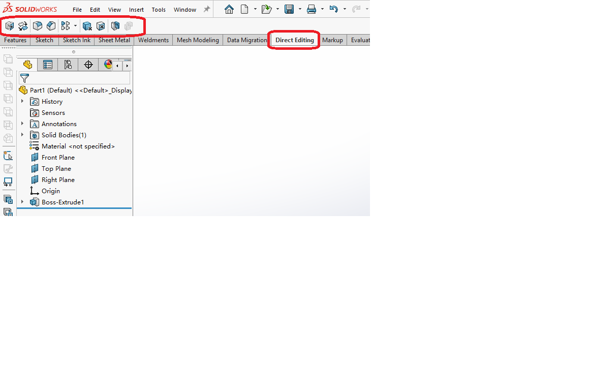

Maybe you can try the "Direct Editing".
Open the STEP file in Solitworks, and then edit it/
