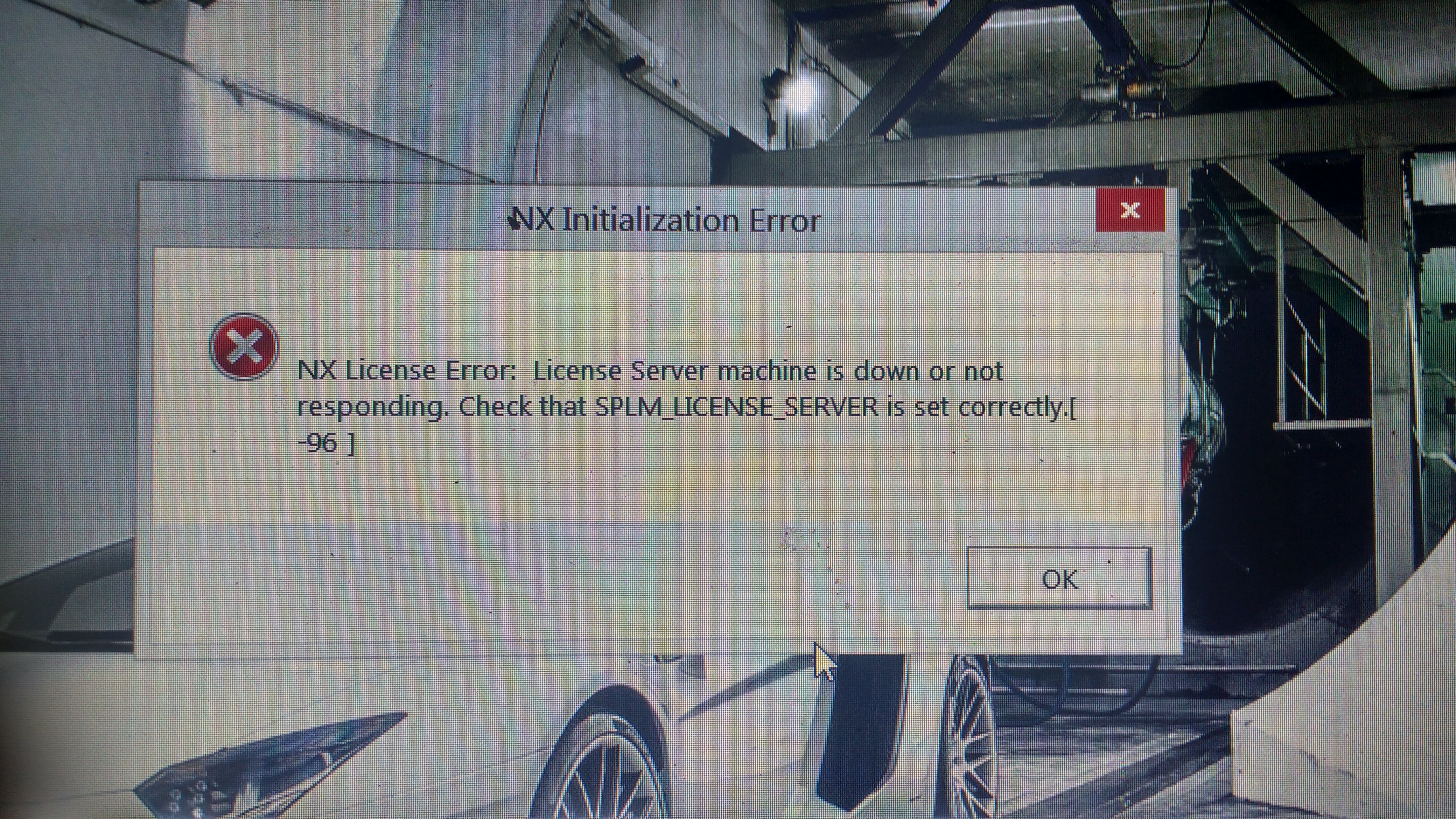

How to fix it? Server down message
By mDesign Center on 11 Sep 17:57 1 answer 886 views 0 comments
How to fix it this problem

    Hi, I'm having this message every now and then if I connect my mobile workstation at home instead of using a different network connection at work.
    The easiest solution to this is to open the "Lmtools" application in the Siemens NX start menu (windows explorer) and to use the "reread license file" command at the start/stop/reread tab. If that doesn't work, I usually have to stop the server and restart it. Then the problem should be solved.
