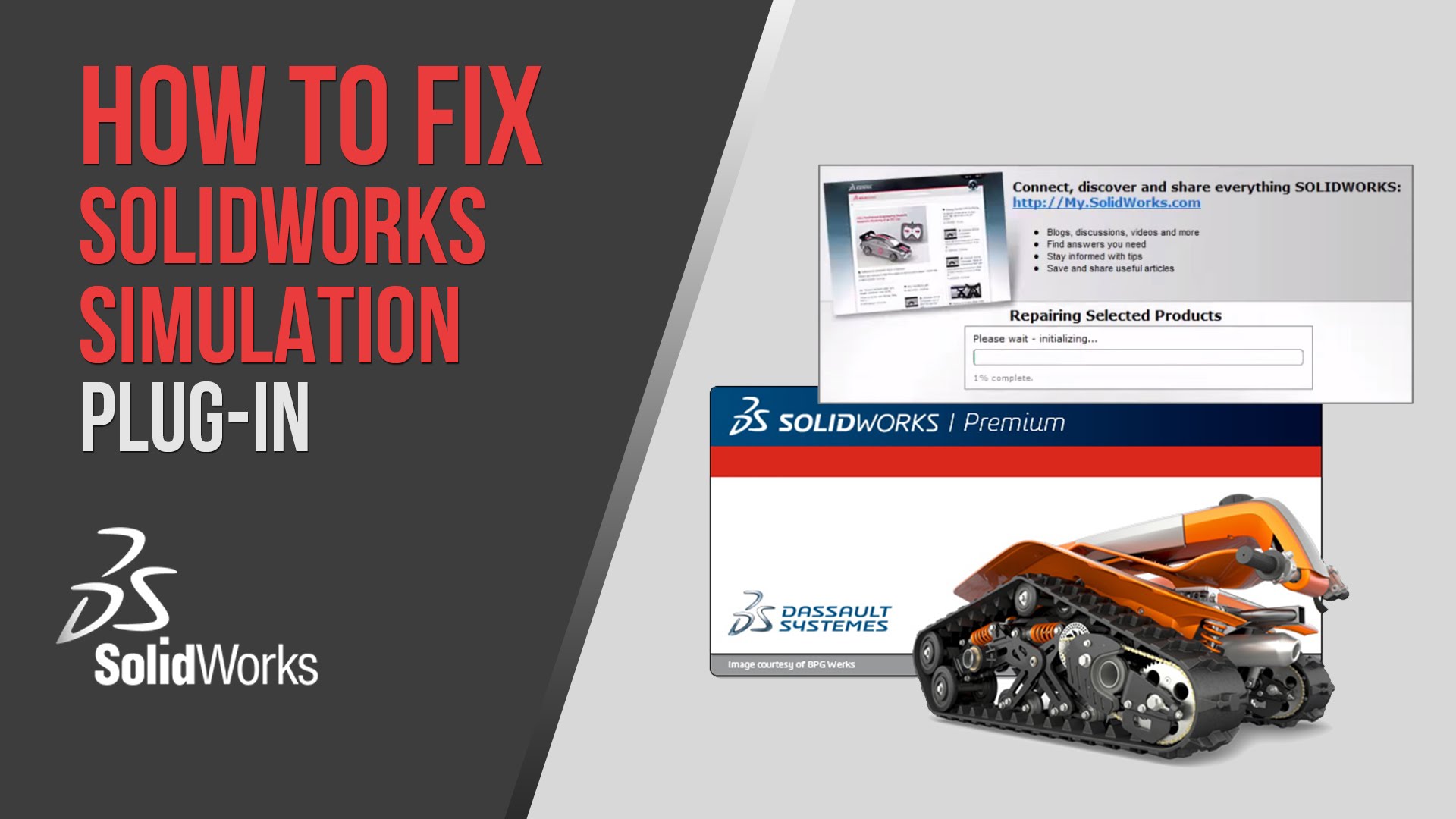

How To Fix Solidworks Simulation Plug-in (missing after installing or upgrading) ?
Many Add-Ins are missing after installing or upgrading SOLIDWORKS if Microsoft KB3072630 is installed.
Video Tutorial : https://www.youtube.com/watch?v=J6AX82pXLq0
