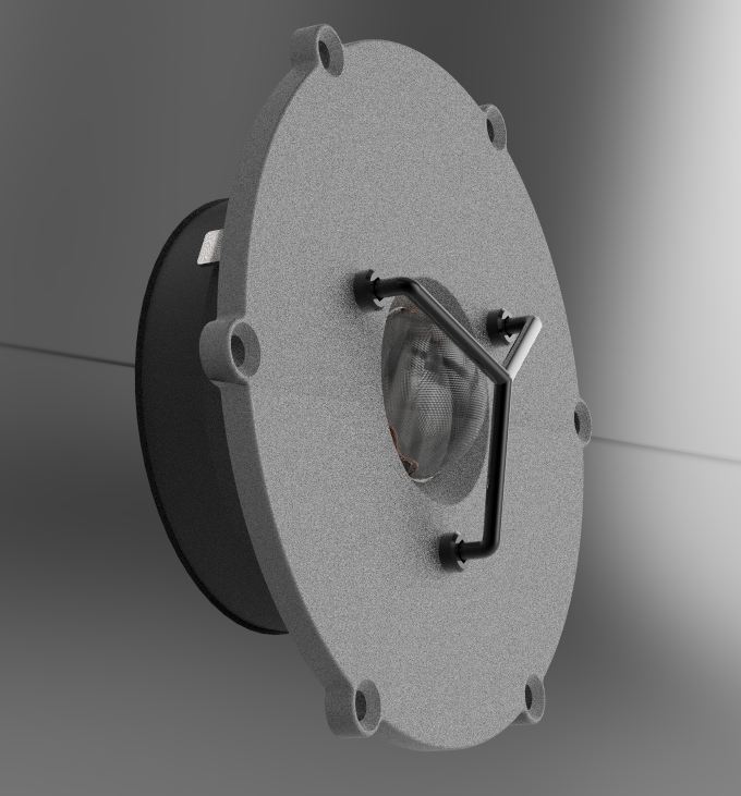

How to get rid off some phantom lines appearing in my keyshot rendering
By Denis Menard on 10 Oct 12:47 2 answers 1181 views 1 comment
Lines crossing the part appearing from no where
Inventor 2015, Keyshot 5
Added images
Square
2 answers
  • Han Farhan
    Han Farhan 11 months ago
    maybe this way I can help
    1.options>camera>not choose "Grid"
    2.options>realtime>not choose "Ground Grid"
    thanks
  • Han Farhan
    or waiting rendering until the line disappears
