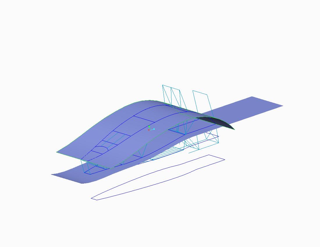

I wanted to hide an exrtuded surface ( which i created in order to make a 3D curved line) as in image. now want to remove the surface from preview and saved file. i tried excluding and hiding the surface . but it is not enough.

Use layer
In model tree , switch to layer mode
Create new layer and add surface to that layer
Right click on layer and select hide layer
Then right click again and select save status.
You will not see surface in that layer until you unhide that layer
U can simply use insert hear for hiding. Drag it and place above the feature u want to hide
