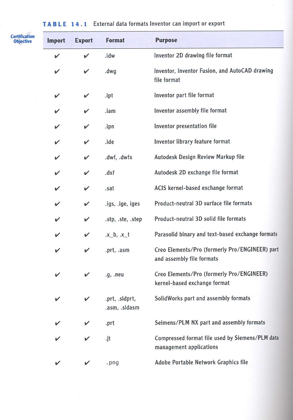

I have one table for your question ,send it to you dear.
