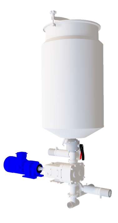

Hi Jeffery,
Yes it works.
Also, you don't need to paint it if you export the collors from Inventor.
Attached there's a picture of 3D Powerpoint.
Thanks a lot for your for support.
