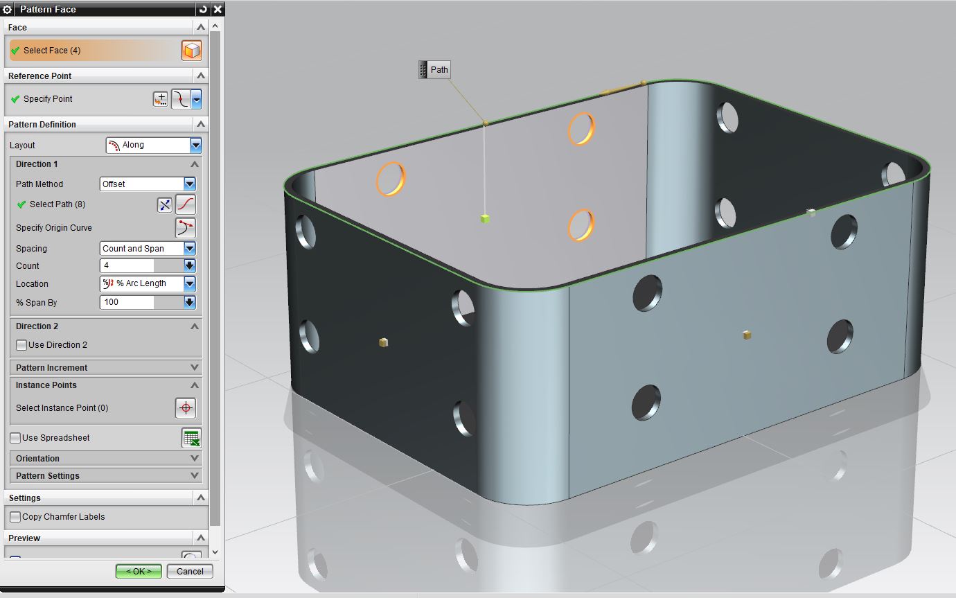

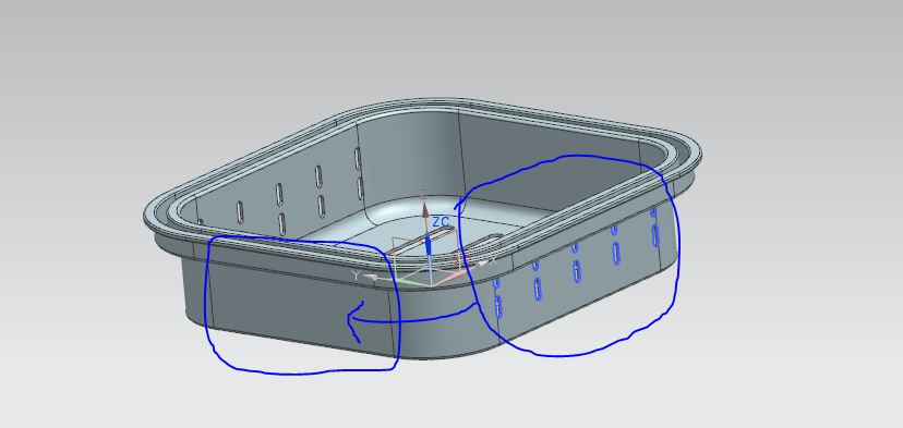

How to make a pattern feature of multiple holes on a rectangular box?
How to make a pattern feature of multiple holes on a rectangular box? Till i get the answer, i will probably do it in a longer way, by sketching on other side too. But short method would be appreciated..

You can use mirror feature>And select new plane as a bicector plane.
Then select both plane as you detailed in image.
Use pattern "along", set the Layout to "offset". Your path is any curve that describes the total perimeter.
You can use Count and Span where:
Count = number of instances
Span = Arc Length % set to 100
In this case:
Count = 4
Span = 100

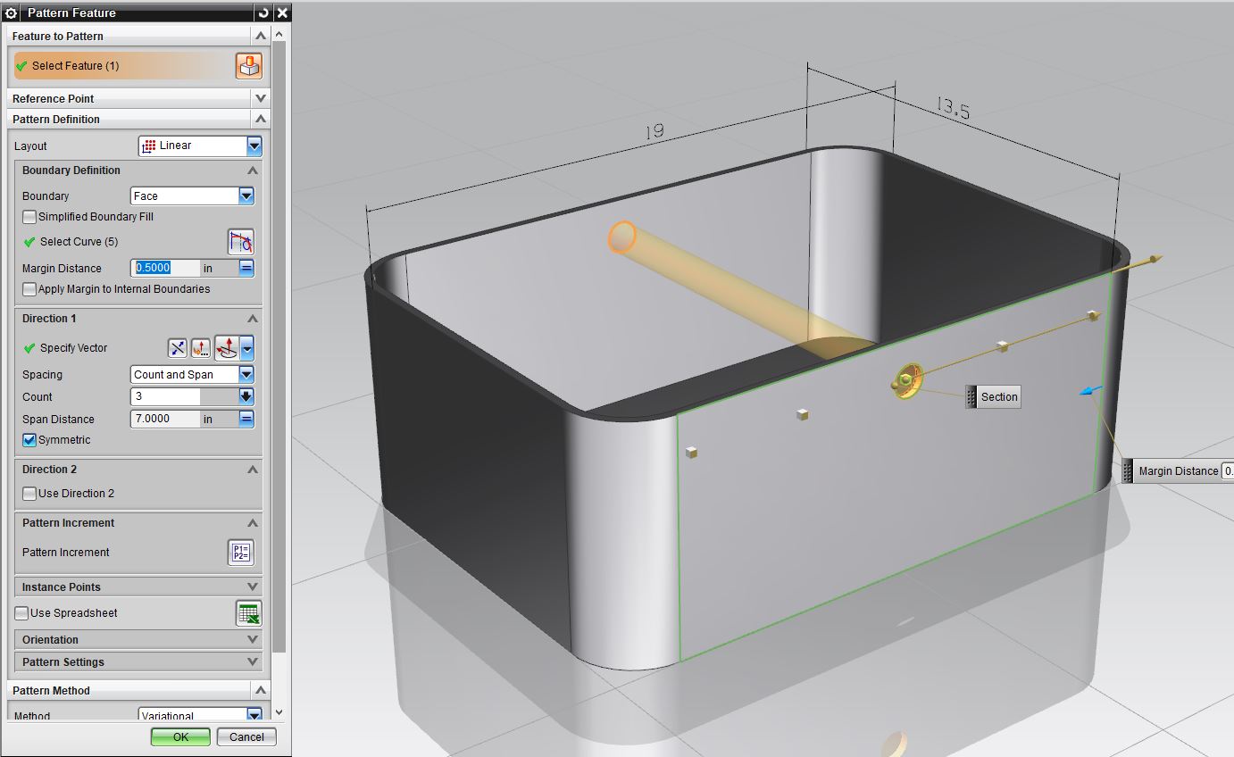

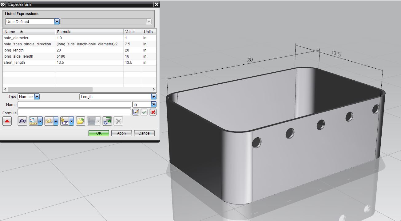

Feature pattern driven based on the 'flat' side length using an equation. Changes in length, update the pattern. Pattern could then be driven to the opposite side using 'along' or 'mirror' and should always update with success for external changes.
