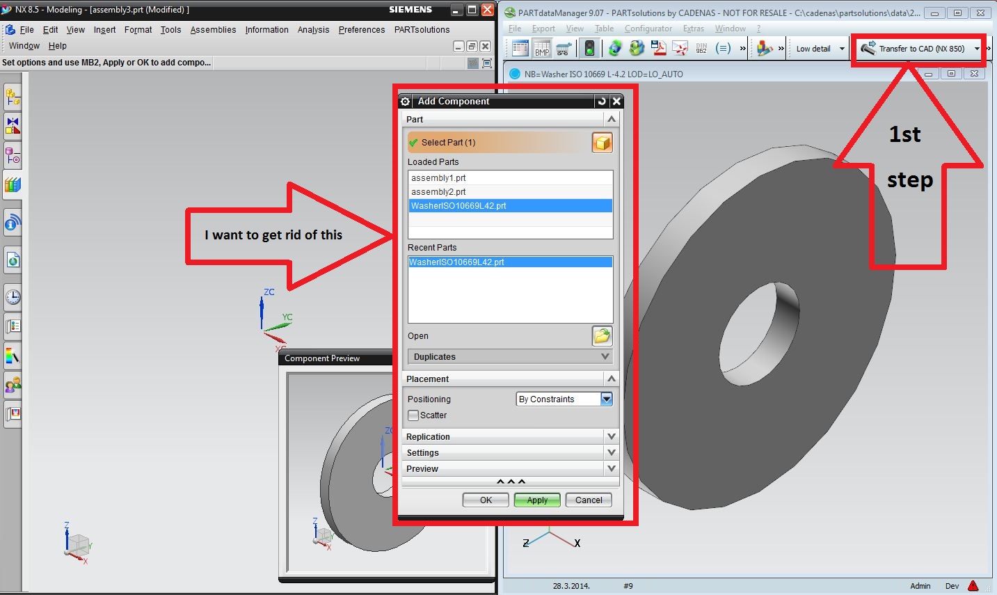

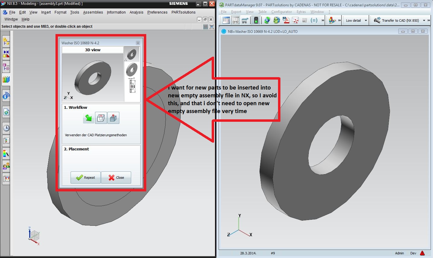

I am dealing with a lot of parts/assemblies (~4500) that I need to test for level of detail and not much more in NX 8.5. I transfer the files from PartDataManager.
NX is a pain as I always have to open a new empty assembly with every new part that I transfer. It also has an insane number of pop up dialogues. Is there a way to make it so that when I select "Transfer to NX" in PartDataManager for NX to place the part into a new empty assembly file by default?

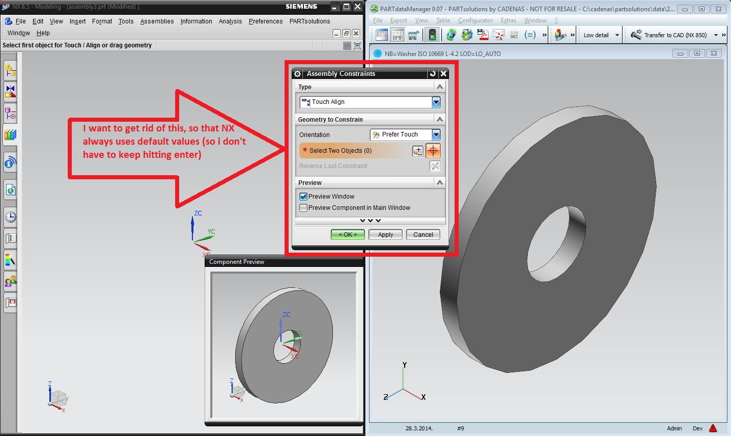

Also, since I'm using default values for everything during import, is it possible to get rid of the "add component" and "assembly constraints" dialogues?

It's tough to give answer to this as you are dealing with some kind of an integration between these two softwares.
Assembly Constraints dialogue shouldn't pop-up unless you choose the position method to be By Constraints while adding a part. The default setting can be changed in Customer Defaults, go to Assemblies - General and Component Operations. There choose Positioning as Absolute Origin or whatever you want it to be.
