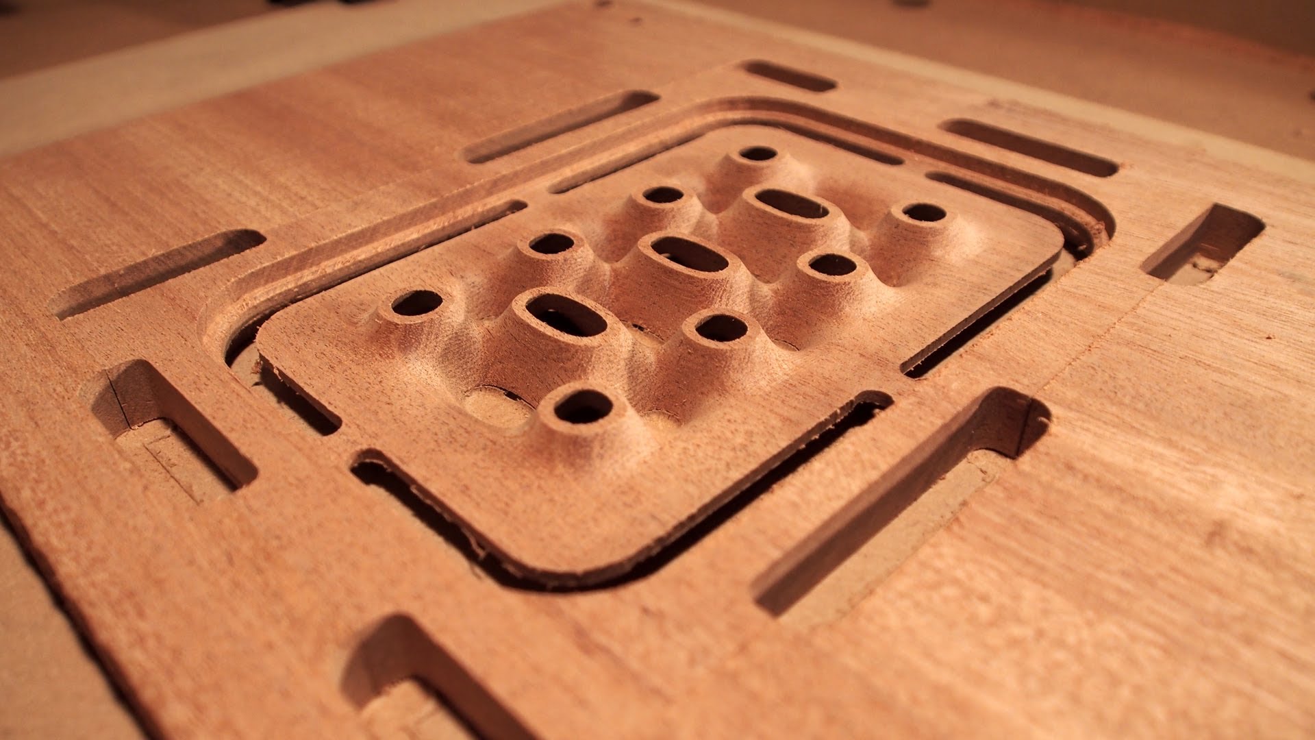

How to make some cone shapes Michael De Landtsheer 29 Aug, 2014 03:10 PM Hello, I have a little question about how we can make some design in Solidworks. medium.jpg maxresdefault.jpg 1 Answer Richard Barber Answered on 15 Jul, 2017 08:20 AM You might try extruding some basic shapes up from a base, filleting in between the shapes, flip it over and shell from the back of the base, then cut the tops off to get the openings.
