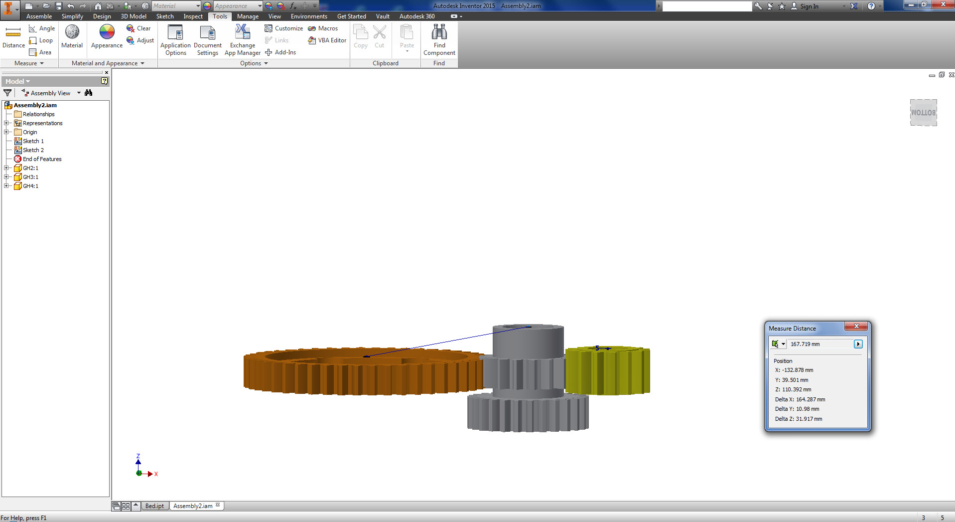

    Looking at how you did it in the screenshot, if you're looking for horizontal distance, select the axis of each center of the gears, rather than the top center points for your reference.

    Can you take a screenshot and post it here? There is a measure tool in the inspection tab up top in the command bars but showing me a screenshot would help me determine what you should select.
  • hasan mikayilov
    hasan mikayilov over 1 year ago
    How to measure horizontal distance between two different points height in assembly avtodesk inventor
