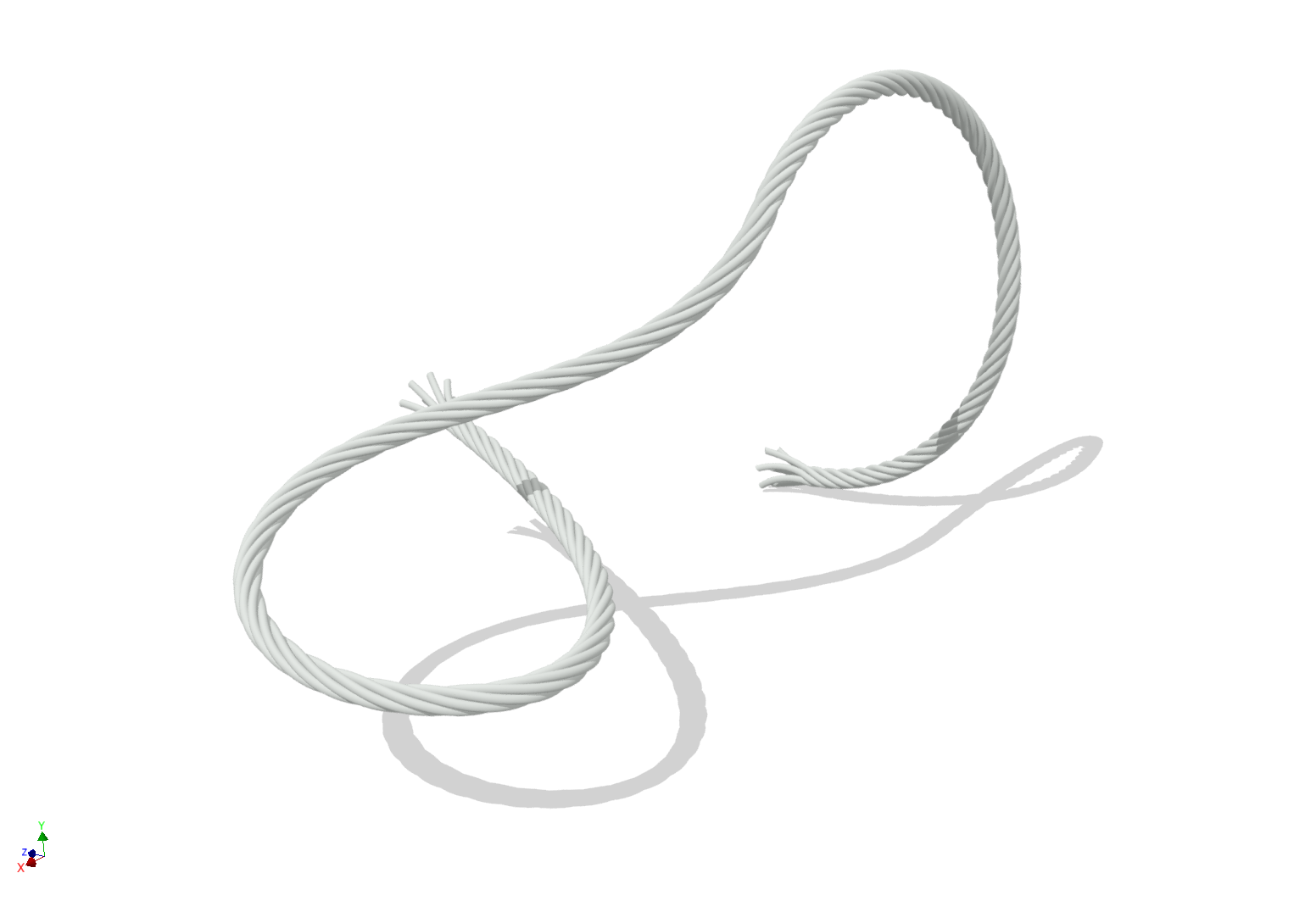

Hello, Here is a part Rope / Cuerda I made for your question I hope it helps . If you would like to check it out and if you have any questions let me know. I made it in Autodesk inventor 2015.
I used arcs and then I switch to an spline, if you have an idea where is going to run this rope you could ad the positions and create constrains for either the spline or the arcs. Also you can twisted as you need. I hope this helps.
