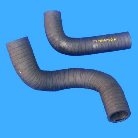

fssane... really thanx for the tutorial, but i do not find anything about hose pipe there. Please see the image i've attached. I need something like that.

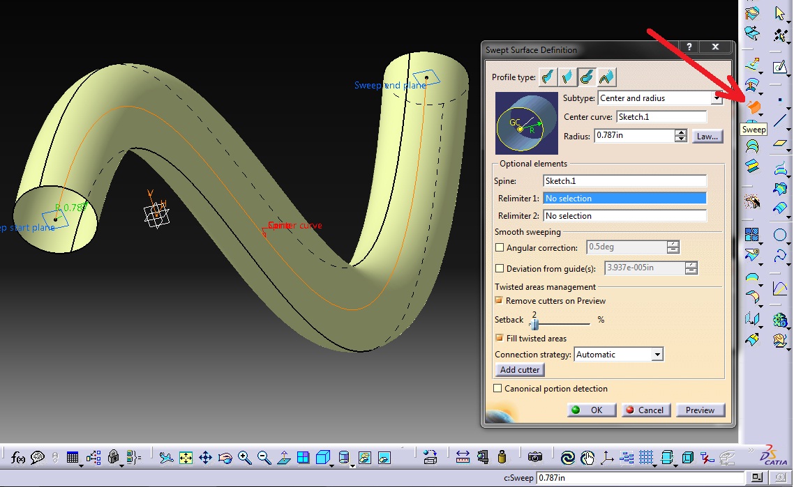

Maybe it's a little late for this answer, but you can use the module "shape design" and use the "Sweep",
